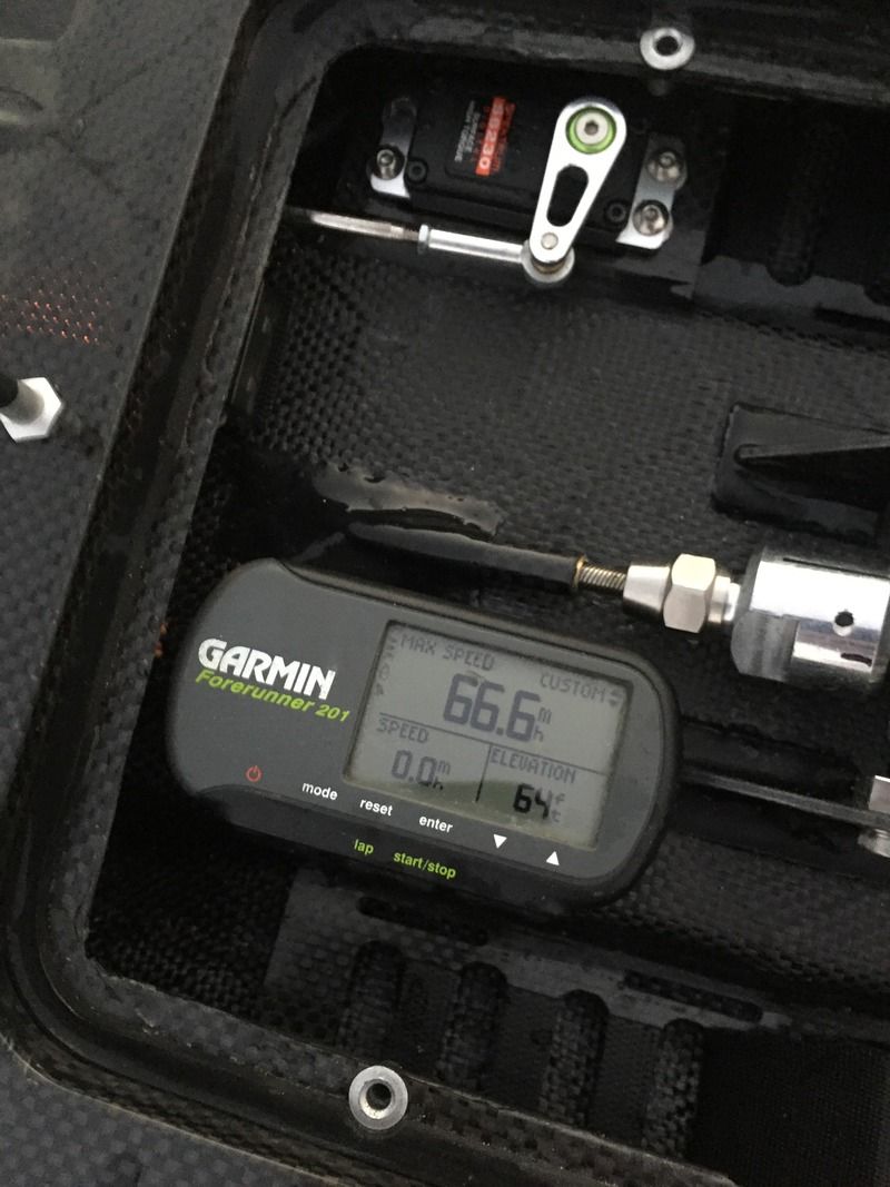

                  Small update. All week I've been working on squaring my ride pads and making them flat to see if it will handle better. Well I went test I today and it did. I didn't get much run time at all, it's been raining. It stopped for a little bit and I decided to throw some 4s packs in the charger. I was packing up and got cold feet with the 4s so I threw a couple 3s packs on th charger and finished loading up. The packs were st 4.05v when I took them off about 10 minutes later. Running out of daylight I grabbed them anyway. Made a pass the way it was last weekend, only change was the ride pad work. 69.8mph and more stable. Batts charged all the way it would have gone faster than it did last weekend I'm sure of it. I worked a new prop while batts were charging. This one was about the same thing I had on it but less pitch. Same diameter. It only lost about 1 to 1.5 mph but it was more stable and the prop walk was almost not even there anymore. Got the courage to throw 4s in it at this point. Nervous. Made a couple little half passes maybe a little more than half throttle. Threw a blip or two in there. Nose came up on one. I brought it in as was about to move the batts further up front (they are a good bit lighter than the 3s setup, 5800 3s...3100 4s packs) and then I looked at the gps. It said 66.6mph. Time to pack up at this point! Lol. I wasn't trying it anymore! I can say that the sound of it when I blipped the throttle on 4s was pretty nasty. If it's not raining tomorrow I'll be back out. I noticed my rudder was angled back a few degrees and I repositioned it to be straight up and down. That should keep the bow down more. We shall see. It'll be another journey like my other Rivercat but this one should be even faster. Heck I started out in the low 60's on 6s with my first one. This one blistered off 68mph on my first 3s attempt. So I'm not disappointed in the least bit!

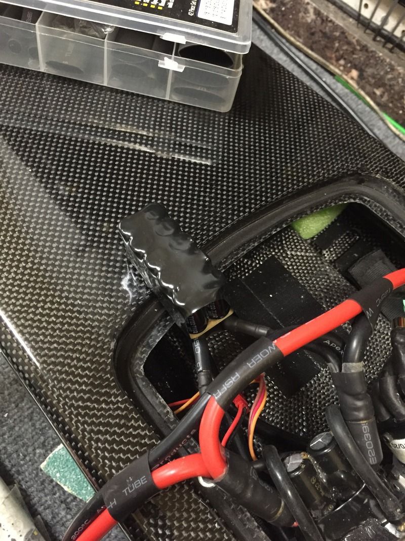

                      Because I'm never happy with anything the way it is, I went back through some notes of mine and noticed that I picked up some speed on one of my other builds by shortening the power wires and adding more caps. Guess the initial setup was preliminary just so see how it was going to work (like I said before) so not everything was as good and tweaked as it could be. One thing is my wires were extremely long. Guess it's better to have too much than not enough. So I chopped off 2" of length from 4 wires. That's 8" less right there. The batteries, well revo offers the batteries with connectors already installed but the wires can almost reach across the room lol. I tried to get them to do them shorter but no luck. I usually have mine about 3". They come about 5.5 to 6". So I'm redoing all those and that is 10+ inches of wire gone. On my cap bank I only have 4 1000uf 35v caps. I made another one with 10 caps just to be safe. Making changes like this on my other Rivercat was worth about 2mph. So maybe it's worth the effort. Got some new props in today to try out so I should have an interesting weekend should weather permit. I'm crossing my fingers for close to 80 on 3s and over 90 on 4s.

                        I am real curious what gain will be had from shortening the wires. This follows my thoughts except that perhaps with short wires the caps may not be needed( in an ideal world).
                          I'll sure let you know. I also added some more floatation to the thing just in case. I put pool noodles wherever I could (under back deck, front and right rear empty space) in addition to the two part foam. I also added some to the hatch. I was reading some old threads of mine and you predicted it on my lehner Rivercat. You asked me if it would float if something happened. Well I had more faith in the two part foam than I should have. I hope this one floats if I have any mishaps lol. It should but I won't know till something happens.

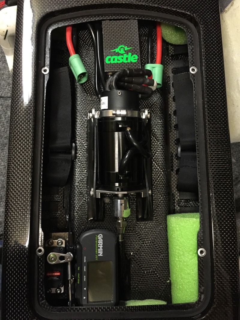

                            Here's a pic that shows the side rails narrowed, moved the gps to the left, used a shorter servo arm (make room for gps and cut the steering rate down) and the pool noodles I added. I wish I could find some black ones. Maybe I could use that dark grey pipe insulation but I'm not sure it floats as well. Somehow need to compare
                            And I added some ugly noodle pieces to the hatch. Don't like it but I'd rather not lose this boat. I'm making every effort to make sure it will float even if it fills with water. Maybe one day I'll get brave enough to try and sink it in a swimming pool. Or not. Lol
