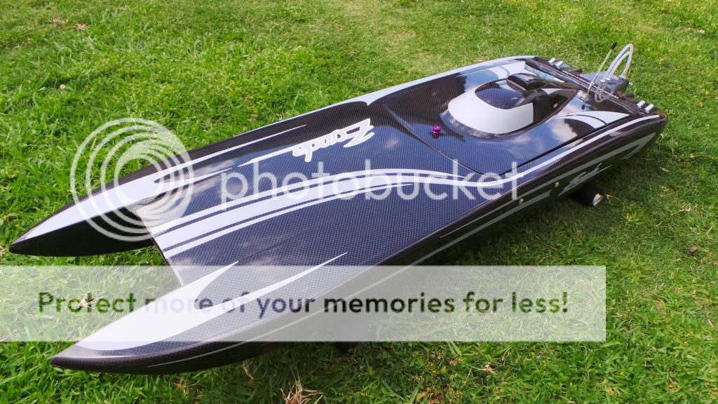

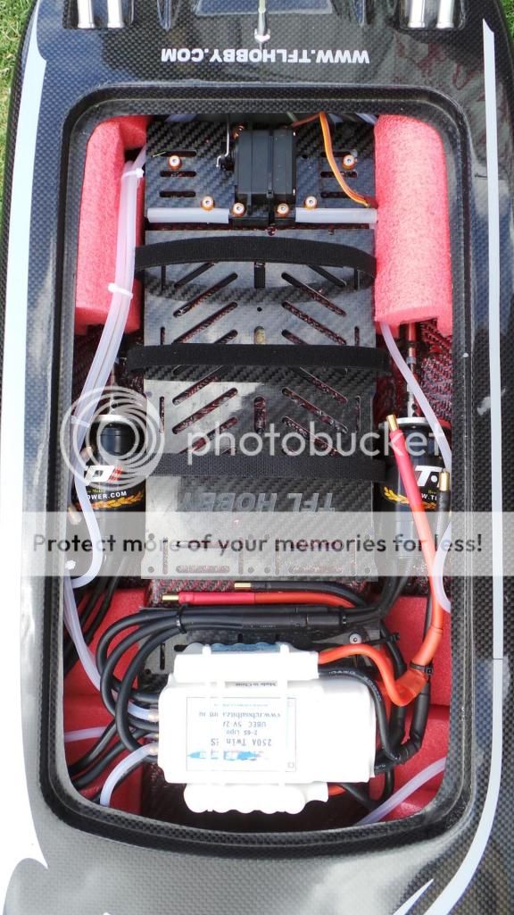

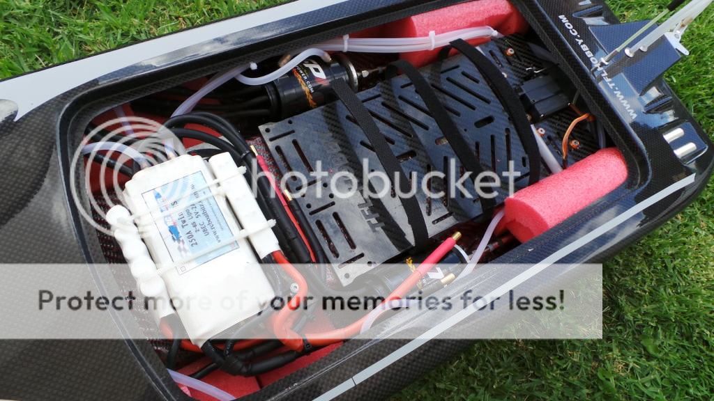

    Hey guys, I've just finished final fitout on the Zonda cat. Just have receiver to install and it's good to go.
    Looking forward to testing the new setup next weekend.
    Ready for 5/6s testing
    Carbon Kevlar reinforcing
    Cooling Upgrade
    RCBB Twin 250amp speedy
    2 x TP 4050 2200kv motors
    Almost ready to rock!
                  Cooling Upgrade
                  Those batteries are going to need to be moved forward and split to lay down properly in the hull. You will experience alot of lift in the position it appears you currently have them to be set in. I have 2 buddies who run this boat, one is in the mid 80's and one is in the low 90's range so i'm quite familiar with the set ups. Hope this helps.
                    Hey bud do you know were there CG is at?? would be interested to know as it will give me a good idea where the packs should be. (wait distribution )
