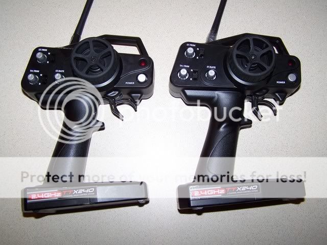

    Im going to take a shot at modding my tactic radio so that I dont have to use pistix anymore with my ICE controllers. I have 2 tactic radios, so I will mod one for ari escs and keep the other one for standard setups. I have 4 ICE escs going into boats, and I would rather not run 4 pistix if possible.
    I opened up my Tactic, and there is one return spring for both forward and back positions. The throttle acts like a rocker against another lever so the spring works both ways. My intention is to notch on side of the lever and add to the other with epoxy, so the throttle returns all the way back instead of to the neutral point. Hopefully it works (If not I ruined a radio).
    I'll post some pics so hopefully this makes more sense.

      It works!!! Thanks to OSE Member Raydee for responding to my PMs and steering me in this direction. This is saving me money and hassle and took maybe 20 minutes to do (a little longer for the epoxy to dry).

        Looks better than a rubberband for sure

                      I see you also have broken the antenna mount. I can see the clear tape on the transmitter on the right.
                        But...look close...can you find waldo?
                        Actually if you take another look you will notice the black tape on the other remote. It's how I told them apart prior to modding the one.
                        I think some people are missing the point here...
                        The idea was to have a remote that works with air escs AND does so like it was made for it. I've put a rubber band on the trigger of a remote before, and it holds the trigger back (provided the rubber band doesnt slip, break, or otherwise malfunction), but there is an overly apparent neutral point where the throttle goes from very easy to squeeze to much more difficult. With my mod you eliminate the tranition from reverse to neutral to forward...there is none. Anyone who used both would choose teh modded version. There really is no comparison. I've actually grown to like the larger throttle range that this remote has more than standard setups with normal ESCs.
