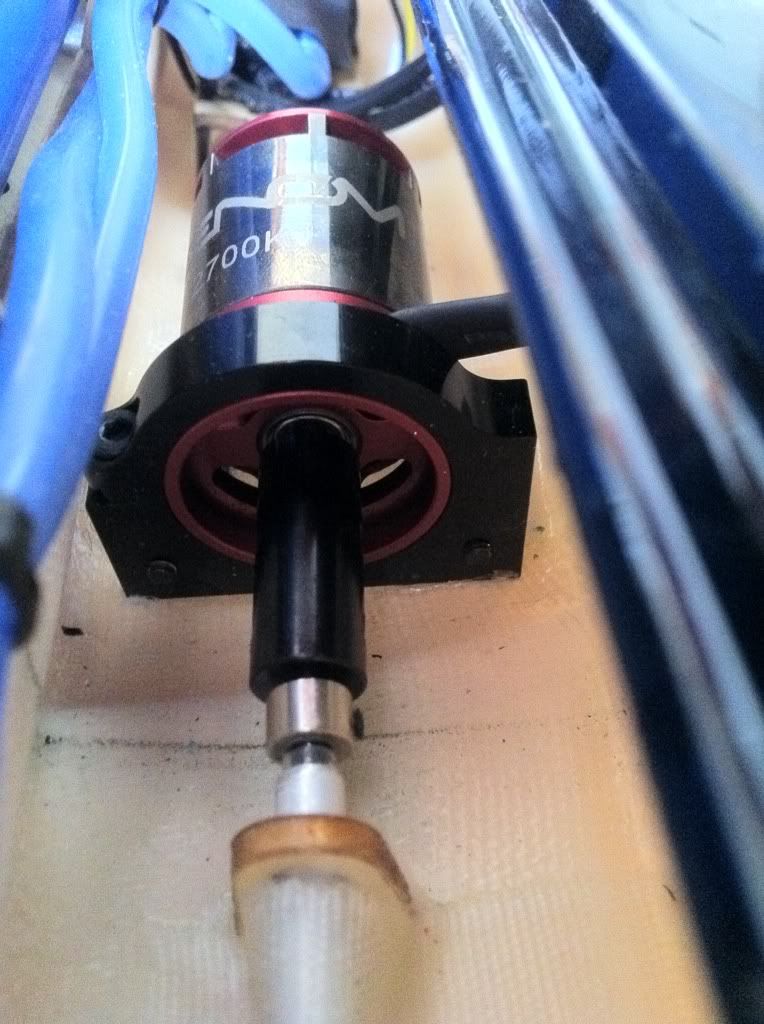

      Well in my case my motors are outrunners and the mounts do not have water cooling, therefore they get pretty hot. So some cooler air inside the hull would do my motors some good.
      Why not water cool the mounts ?
      • dont slow down
        • Feb 2011
        • 120
        I can't, the mounts don't have cooling ports built in and even if I made some attachment it wouldn't do much since it's an outrunner.
        Here are the mounts I have.

          Don't slow down.
          I don't know why you think water cooled mounts on outrunners wouldn't do much. They do a helluva lot.
          With the mounts you already have in the boat, why not try just bolting on the aluminium part of this mount to the front of the motor. If space is limited you could even cut the 'wings' off where the mounting screws attach the side plates. They won't be needed.
          I always use some heat transfer silicon between the motors & mounting plates for added efficiency.
          http://www.offshoreelectrics.com/pro...prod=ose-80100
          Just think it would be a cheap easy fix for you.

            I'm not saying water cooled motor mounts won't do anything, I'm saying mine won't. There is nowhere to run water through them. My motor mounts are a clamp style. My motors don't have mounting holes to screw anything onto so the mount you posted won't work either. Eventually (and I do mean eventually) I will replace the motors and at that point I'll get water cooled mounts and motors that can be water cooled, but until that day I was just toying with the idea of air cooling them, wouldn't need to be a lot, just a little. That's why I was thinking of the auto bailer and how I could incorperate those kind of physics into a air vent that sealed if turned upside down.
