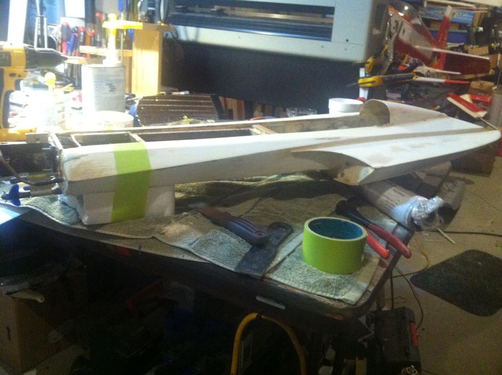

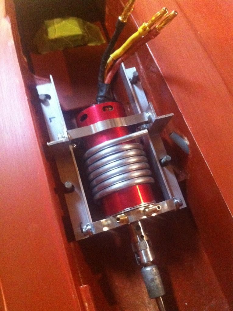

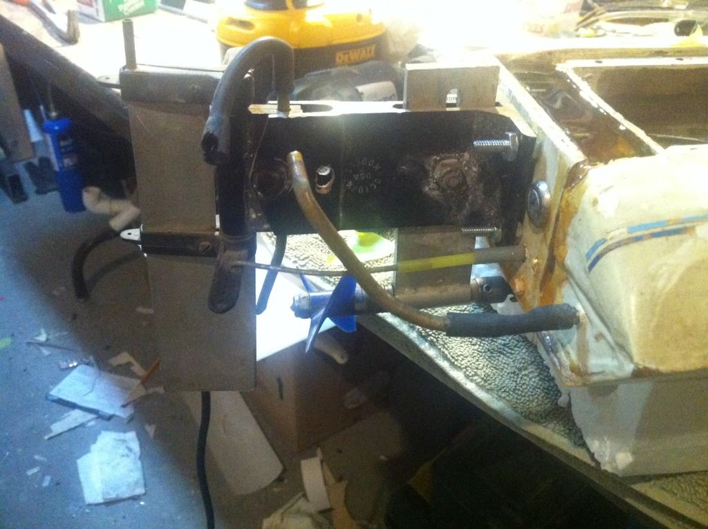

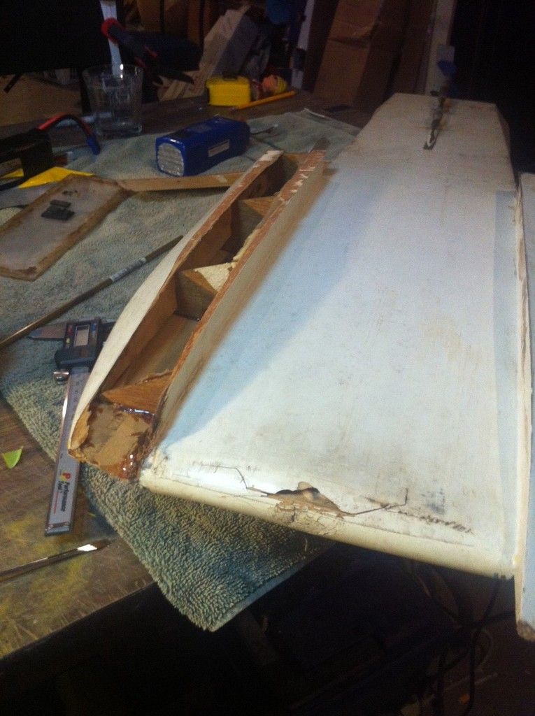

    I am a CAD scratch designer/builder of large scale Electric RC planes. Someone from our club brought in a box of old rc stuff and in the box was a damaged Dumas Atlas Van Lines #1304. Since I love to build I thought I'd take it on. (I always wanted one of these when I was in high school back in the 70's) I had to resheet 1 sponson, repair main deck and make a tip for 2nd sponson. I have done all the repairs and am now fitting parts. I had a nice 36mm EDF motor out of a large Starmax F4 that had crashed. It is a 2000 watt, 1500kv roughly 2.5 HP on 6s. Looks a lot like a Neu. It was a screamer in my jet. The original owner of the boat had a 7.5cc K&B engine in it with a solid 2 part 3/16 shaft with Octura joints and a Z60, 60mm Octura plastic prop. I have removed the solid shaft and have a 3/16 Octura flex shaft on the way. I have a Leopard 5698 but any 56mm motor would be too heavy and too large for the hull. With my 36mm and a 4000mah 6s bat and all electronics I get a good CG about 1.5" from back of sponsons. Since this is my first boat I am not interested in max speed right now but am wanting it to at least get up on plane. I realize that by todays standards it is a real heavy boat. By all comparisons I am putting out more power and RPM's than the stock K&B engine. Is my thinking cogent? Any info would be great.

    A 36" hydro is typically powered by 6S, but almost never by a 36mm motor with such a high Kv. That motor lacks the torque needed to spin a large prop and amp draw will likely be excessive. Plus it may not plane the boat. A 40mm X 82 mm motor is called for, with a Kv closer to 1200; even a Kv of 1000 would work well for a heavy sport boat.
    Suggestion:
    http://www.offshoreelectrics.com/pro...?prod=leo-4082 Choose the 1000 or 1250 Kv.
    And this ESC:
    http://www.offshoreelectrics.com/pro...seaking-180-v3
    And no plastic prop! An x447 or x450 should do well safely. These choices will work far better than what you have. Using what you have risks poor performance and a melt down.

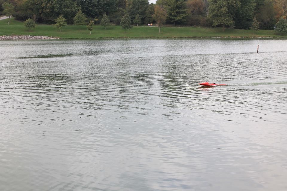

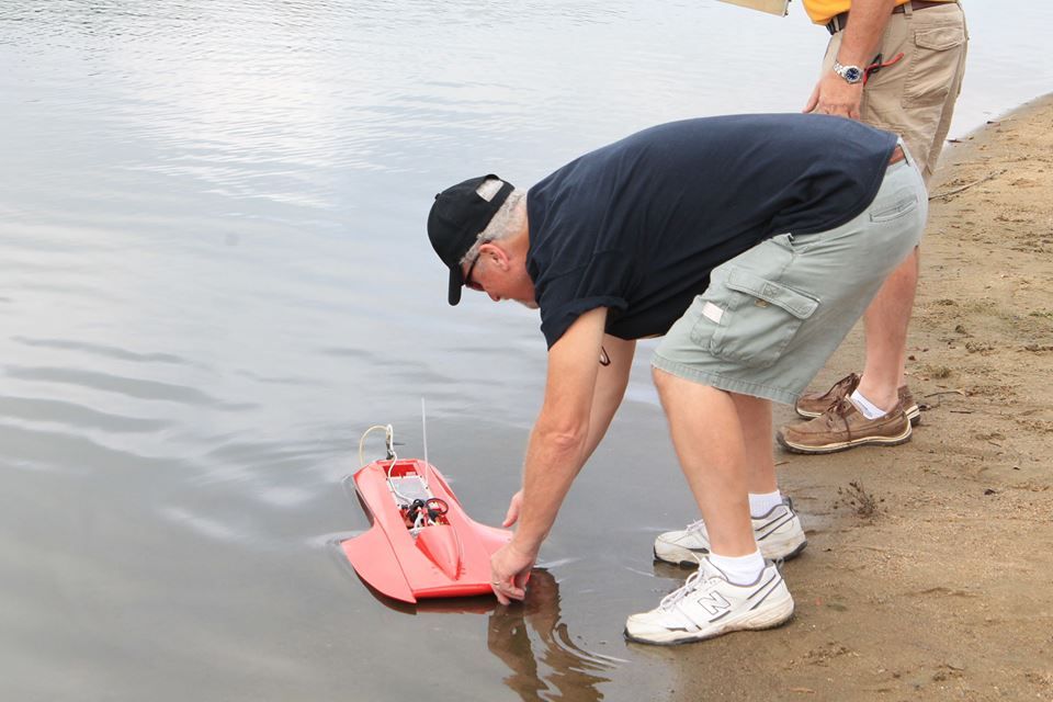

                            Well..... I finally got a chance to take the Dumas Hydroplane out for a test at our float fly this weekend. Boat did about 45 mph. I must not have tightened the compression nut on the shaft enough because on the final run I heard it just spinning and we had to pick it up with the rescue boat. It was fun though and I learned a lot. It got up to 45 then went into LVC so I assume I need some 45-50 C batteries. It was a blast to run and will be real fun once I get the bugs out.

                              3rd pick was taken just before it really got out of the water.
