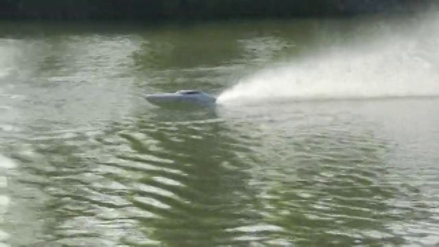

          Just found this on youtube. Pretty much what I'm looking for.

            Hey that looks pretty good Scott,
            Dose he say what motor he is running and on what S cells ?
            It sound a little ruff in the drive I think,
            May be some binding on the flex shaft.

              Its actually a fine design build. I think 5692 motor set up for 10s, but they call their motors nemesis gold, and I'm not sure of the esc. I got mine on ebay. Just found a new one at towerhobbies in the scratch and dent section with box damage only for $720. If you have super saver club membership you can save an additional 50-105 bucks and free shipping.

                  #23
                  This Fountain KOS is not very fast, Have a look to this 58" deep vee twin setup with two 4092, 8S on each motor
