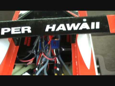

An other picture This P1 hull is nice, finish is very nice tooLast edited by Alfa Spirit; 06-29-2019, 07:19 PM.Comment

I' ll put the Scorpion in the Rapid, the P1 KOS will be powered with twin FMT 3650 1700kV with 2x5SComment
