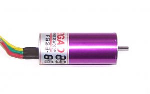

    I see these motors are a good upgrade. Are they a drop in replacement or a little work needed? If so what all is needed to complete? And can you turn a larger prop with these?
    But 9xl or 10xl better for 3-4S lipos? because I may try to get 4S if I cant get this thing to break 50mph on 3S
    Where are you guys getting the wire drives from? I seen them one night in a search but didnt save it on this pc.
    • LarrysDrifter
      Big Booty Daddy
      • May 2010
      • 3278
      Read the SeaKing 120esc thread and others.There will be all the info you can ever need on upgrading these hulls.And 9xl's and 10xl's are good motors that bolt right in.Youll be spending alot of money on this to get good speed out of it.Wire drives and other drive hardware is from rcraceboats.com.click on the EKOS part and youll be there.Be sure you read up on things before you buy.

                            • scubasteve95
                              • Apr 2010
                              • 239
                              [QUOTE=JPriami;217126]I ordered a Dragon Saga cat from the UK this week. I did a bunch of looking around to find the specs of everything and now I might be heading for trouble. because I was originally going to buy the new EKOS with the new outrunners. at that time I ordered new lipos for the boat and 36mm machine props by venom. But I ended up getting this other boat thats a clone of it because I liked the paint better because its not the EKOS paint job like everyone else has. So I want to know whats best or has been proven to work best to upgrade things like the motors in the EKOS boats.
                              Here is a couple pics of the boat.
                              Specs:
                              Length - 820mm
                              Width - 240mm
                              Weight - 2400g
                              Speed Controller - 2x 70 Amp Water Cooled (Included)
                              Servos - 1 (Included)
                              Motor - 2x Water Cooled 2636kv brushless (Included)
                              Battery - 2x 11.1v 2100 - 4500Mah Lipo (Not Included)
                              Hull Material - Fibreglass (FRP). Propeller - D36 x P1.4
                              The ESC's are 70 amp
                              Specs:
                              Type - Water Cooled
                              Voltage - 7.4 - 22.2v (2 - 6 cells lipo)
                              BEC - 5.5v @ 4 amp
                              Battery Connector - T-Style
                              The motors are Feisuda 380 2848-2636Kv
                              Specs:
                              15 Turn
                              27 Amp
                              0.0341 Resistance
                              2636 Kv
                              0.9 I0(A)
                              When I ordered my lipos I was thinking I would be gettin gthe EKOS. I ordered Hyperion EX 3S 5000mAh 45C packs
                              these packs will work just fine....keep it stock and run her.
                              3s-4500 or 3s 5000mah no real diff.
                              motors are less kv then the ekos...thats good
                              nice paint....makes me want to sand and paint my ekos
