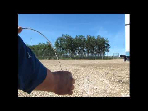

          Hitting that tree branch also may have started the stock cable to "kink" a bit, then just got worse from there. The strut out of alignment also a good candidate. (as per Fluids info)
          Fluid mentions quality cables, here is a brief video comparing Traxxas OEM vs an aftermarket shaft:
          Another condition that can be hard on shafts is running in very rough water, if the boat is coming out of the water, unloading the drive line, then loading hard again when the boat hits the water again, this can take it's toll. A good flex cable will take a certain amount of punishment, like occasional jumping a wave, but continuous in and out in rough water can be hard on them.
