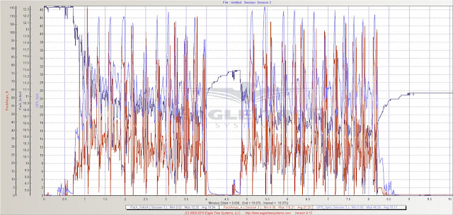

        Go the boat wet today, not the best day. Rain, but the lake was calm
        Ambient 69*f
        4s
        Max speed: 34mph
        esc: 93*
        motor: 95*
        Amp loading is higher for some reason.
        That may have been the reason they didn't use a 4-pole in the first place, would suck too much from the stock nimh.
        6s
        Max speed: 46
        esc: 117*
        motor: 112*
        Performs much better on 6s
        As far as speed, that is a product on many factors, prop was a little nicked and I'm tired or replacing them:
        Pro boat stainless prop that they're using on everything now(=P215) drive dog is available here.
        Forgot how nasty the stock cable made the grease, back to Jeff"s to see if there's a difference.
        Also not that happy about the temps, they are low, but so was the ambient and it was raining. Still have the outlet so I'll see if a parallel loop can make a difference.
        It'll be interesting to see how fast the new components can push it

          Still have some trimming to do. Had the packs an 1" forward from the back, have to move them forward a little more, chine walking may have been the limiting factor.
          6s
          Max Speed: 50
          Motor: 113*
          ESC: 109*
          More speed is there, I just have to work on trimming it out. Cooling loop obviously doesn't seem to matter with temps
          Jeff's cable is hands down better than the stock one, but the drive line temps didn't change much. The liner had turned slightly with the stock cable, but stayed with Jeff's without re-gluing it. However, that's been with the stock stuffing tube, have to see what my re-design will do.
          The motor did solve a large part of the issues, but I would not call it solid yet. The drive line issues will still occur.
          It is easier to work on them without the motor burning up though
