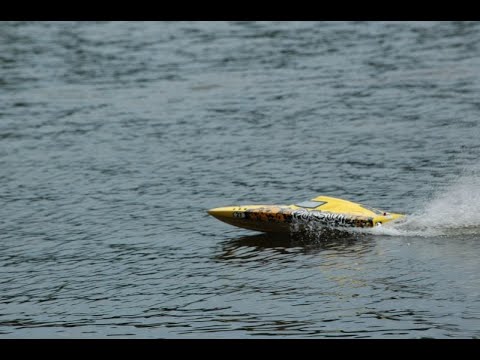

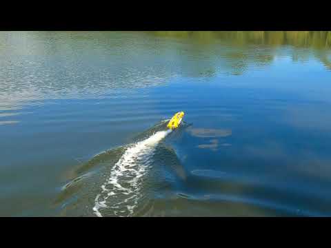

                Some durability testing, starts at ~ 20s but the BlackJack29 is fun as well just prior.
