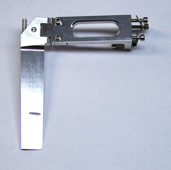

      Thanks to Joshua (shua), who just PM'd me pictures of the Kintec rudder he had successfully ran on his Voracity. It's unfortunate I can't just go and order the part from Jan, but I do have a full spec sheet to go hunting with.

          OSE has the same rudder.
          https://www.offshoreelectrics.com/pr...prod=ose-80050
          Larry

            Yep, ordered it and it was delivered The other day. Hope to have it installed before the weekend.
            Vac-U-Tug Jr (13mph)
              Should have text me. Lol. I have lots of spare parts. I have one of these rudders on my voracity and my m certain I have a spare.
              Put a shorter servo arm on the servo or move the linkage in a little closer to the rudder. That will shorten the throw.

                Will this rudder fit the stock (revised hull) model without having to drill new holes? It looks sweet!

                  No. The new rudder has 4 mounting bolts and they don't line up with the 2 existing holes. 8n theory, you could get away with only drilling 3 new hols, but trying to reuse one original hole is a compromise on location and doesn't really save any work. I've sealed up the original 2 holes with JB Weld and will drill the new holes next.
                  The new rudder has a pivot point more similar to the original rudder design so the swing arc of the rudder blade will be less than the revised proboat rudder.
