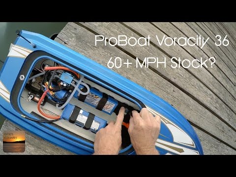

                  wanted to ask if someone has already the "safe" setup for reaching of 60MPH with this boat.
                  Any advice would be appreciated.
                  Thanks, Niky.
                  • arrover
                    • May 2015
                    • 322
                    #294
                    Niky there is a lot of info in the Voracity tuning thread but here's a general overview. You can run 60 with the stock ESC/motor and a prop change. It is on the edge of being safe though (in my opinion). It is safe for running a couple of back and forth high speed passes but you will have to be very careful "sport" running. It may not be safe to run a full set of packs with that setup. If you switch to a 180a ESC it might be safe to run 60mph for a full set of packs. The important thing is that you check your temperatures often when you are testing a new prop/gear/setup. Someone may have an identical hardware as you but your temps may be different depending on how you run the boat, water conditions, boat setup/tuning, prop finishing, etc, etc.
