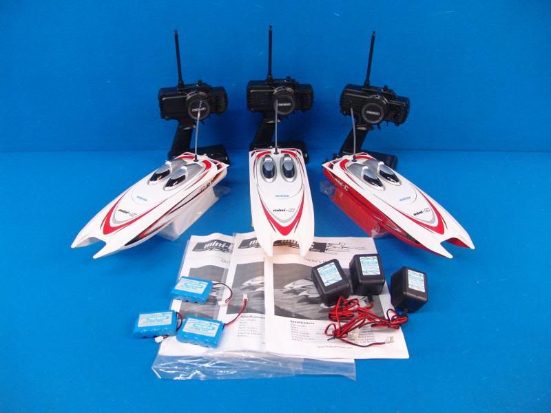

                    Thanks guys. Just bought 3 used Mini C's!!! They came as a package deal...and there might be some things that don't work but I plan to get them all up and running like new and Plan to sell one or two of them depending on what parts, if any need to be replaced and my cost involved in doing so....so if anyone is planning on getting one of these I should have some to sell in a week or so!
                    Better yet I got one in each color/frequency...a White one, Yellow one, and a Red one
                    So I have been into R/C for 1 month now...and this makes...uh 6 boats and 1 truck in my collection...ya I am gonna have to sell one or two of these lol
