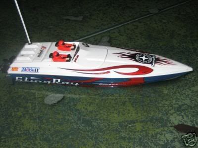

    Hello. I am fairly new to RC Boating and recently purchased an upgraded ProBoat Mini-V with trim tabs, stabilizers, an aftermarket prop and coupler. To my knowledge this takes care of the usual weak spots on what I have heard is a great little boat.
    However, I have been into RC Cars for around 6 years so I am looking to swap in my Airtronics MX-3 equipment and a mini servo out of my rc18t. I am aware that if I do this i'll likely need to replace the ESC. I currently have an extra Quark 33amp Brushless Car ESC. I am worried about water issues though. Can anyone point me towards a good waterproof brushed/brushless esc? I will be running 7 Ib1200 cells. i've also heard that my Mamba 5400kv motor would be too much in the boat. So I'm looking for a motor/esc comob.
    Thanks for all the help in advance. Here's a picture of the boat

      I am not familiar with how much room there is in that boat but off hand I would think that the SV27 ESC and a Feiago S or L series would work.

          The stock esc isn't waterproof, i say just make sure you tape the hatch really well, and run the Quark.

            I ran mine with a SS45 ESC (same size as the SV27 ESC). SV27 motor is too big though. Just be careful of the prop you choose, more power + bigger prop = torque roll.
