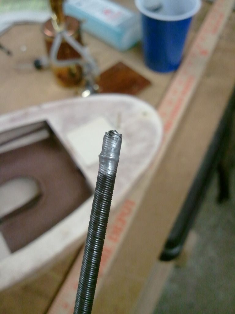

                              #29
                              I smoked my stock esc on mine just pluging in the batteries. at first i thought i hooked them up wrong but no...everthing was right! so i put the seaking 180 and leopard 3674 1700kv motor and esc combo from my BJ26 in my impulse so i could still run it. I love that i can still do 35mph on 4s and still run 6s if the water is flat. the last time i ran it i snaped the flexcable at the solder joint and lost a S/B m445 prop! this bumed me out and ment i was done for the weekend. what can i do to make sure this dont happen again? or was this just a fluke thing?

                                #30
                                How long have you been using the coupler? May be a contributing factor, the set screws "bite" into the cable, collets "grab" the cable evenly.
