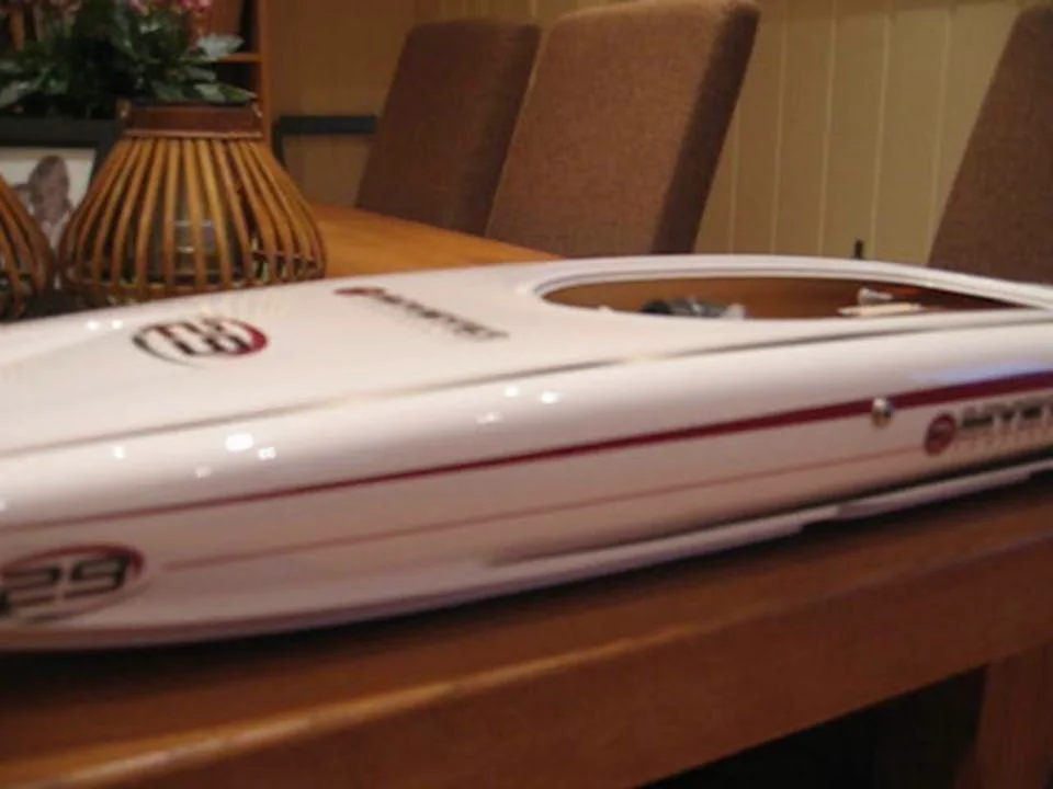

        here is the hull. Not so true I had hoped for

          • 7673
          Make sure your strut is up out of the way before you pass too much judgement.This is where the blueprinting of the ride pads comes in.
