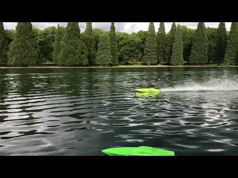

                    Finally got her out to the local casting pond yesterday, the first time she's ran in 3 years...
                    Ran her with dual 3s batteries wired in series for 6S total power with the K45 prop. got up on plane no problem but the top speed was okay. Wasn't super slow but not super fast either. I would of hope for more speed but the motor and ESC temps were really low. Maybe she has some room for improvement. After about 5 mins of running, something got disconnected. I heard the motor scream but no movement. I for sure thought the prop came off but after getting her back (btw never go out again without a recovery boat!) the prop still attached. Pulled out the flex cable and it didn't break but failed. Not sure what happen? Maybe you guys can let me know what went wrong?

                      #25
                      Here is the running video before the flex shaft failed

                        It looks like you have a reverse cable installed, and as such, were spinning it the wrong direction. Doing so, causes it to unwind, increase in diameter, and cause massive amounts of friction. You're going to need a new collet, a new flex cable, a new teflon liner, and possibly a new brass stuffing tube if that was damaged.
                        Think of the flex cable like a spring, it needs to be spun in the direction that tightens the coils.
