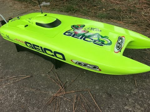

    My son and I bought the V2 he got the Geico I got the Blackjack. Ever since then I wanted a Geico and here she is, Bran new out of the box. My goal is to make some small upgrades. First thing to do is reassemble it, clean it then carbon fiber the nose and the seam, upgrade the flex shaft and strut, new 440 sharpened and balanced prop. My Blackjack has been running close to 50moh on 2 3cells since I got it with no issues. I am hoping to get the same results with the Geico. Not looking to break records just good sport running.

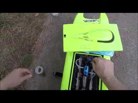

    Nice! You might consider mounting that motor in the other holes due to the way it's turned on the mount because you will only be filling half of the water jacket with water due to the water inlet being higher than the exit point. Or you might be able to twist the jacket a little with some pliers. It's a bummer yours didn't come with the new updated motor though. The Geico v3 runs decent below is mine.

                  DE83AF29-2F24-491E-B3B7-74139A94ED2B.jpg7B1F7BC6-8C66-4EC7-BE6E-8B7E28FBCAAE.jpgCF00A248-9893-4F4D-8FA6-21CC31C9A18C.jpg3ECA1514-2CBB-4CBC-BA51-707AD3665A3B.jpgSome inprovements done, CF on the nose, I added epoxy to the seams. I reinforced the transom. Added pool noodles, new coupler, OSE flex. I got a strut from OES but the inside diameter is to big for the stuffing tube. Stuffing tube Diameter is .236” The strut ID is .257” Waiting for the brakeaway rudder and the S and B prop.
