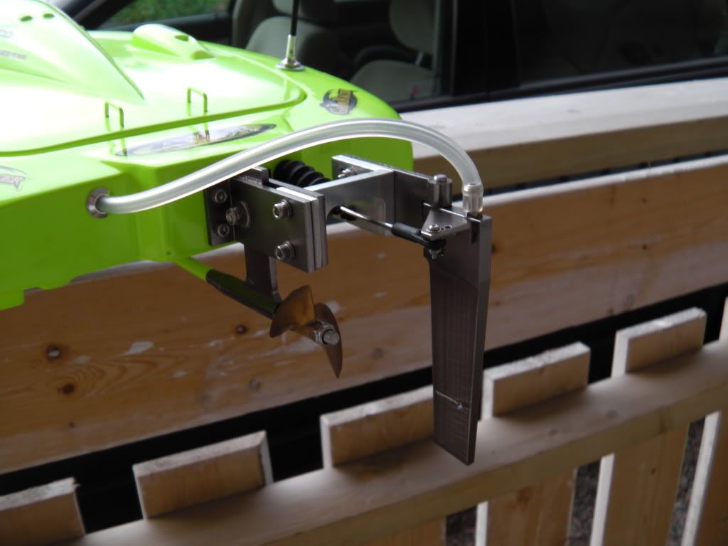

      I have the one that he is selling on the netshop now is that the v2? I have pics I can upload.
      Edit: Here´s the pics anyway, that´s a x642 installed. with 3-4mm of clearance from the bracket.

          I would suggest using a plastic bolt on the lowest mounting point on the rudder so the bolt breaks instead of the bracket. you can see it in my pics it worked for me when i hit some drift wood in the ocean :)

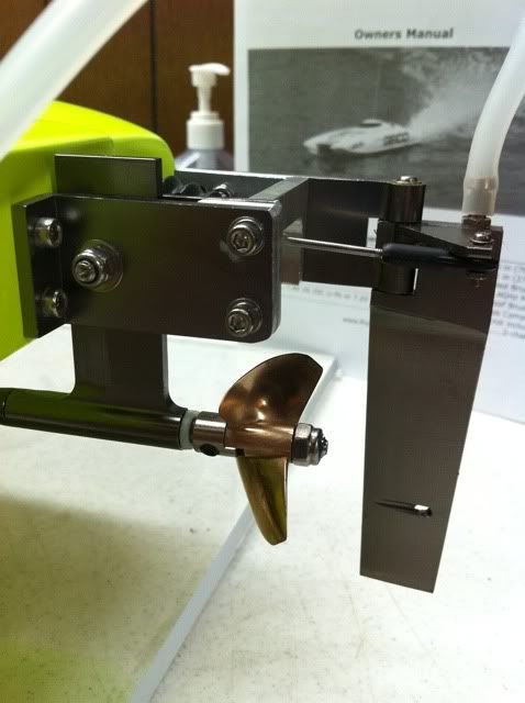

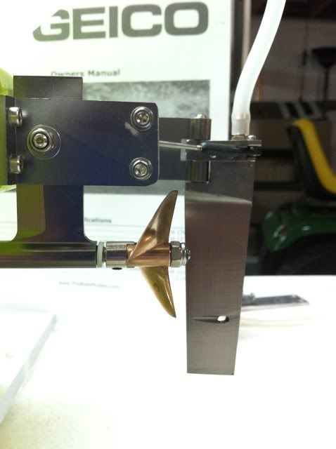

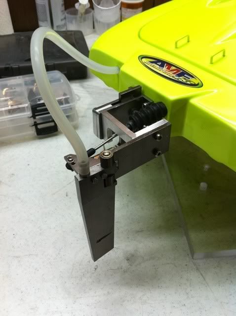

              Got mine today installed and trimmed the back off the bracket that hangs over the prop. So I don't have to worry about it hitting with adjustments and larger props.

                  [QUOTE=JPriami;339191]Got mine today installed and trimmed the back off the bracket that hangs over the prop. So I don't have to worry about it hitting with adjustments and larger props.QUOTE]
                  That looks like a real clean trim job, and i'd like to do the same. Would you let me know what you used, and/or how you did it? Thanks!

                    Peacock8,
                    Where did you get that antenna?

                      Its partly homemade. The alu mount I bought at OSE, I put a alu spacer underneath it for added support. The tube is evergreen plastics that i painted black.

                        [QUOTE=Nealkot;344000]
                        I just used the metal cut off wheel on my dremel. Then filed the end and edges a bit.
