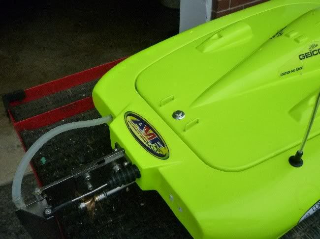

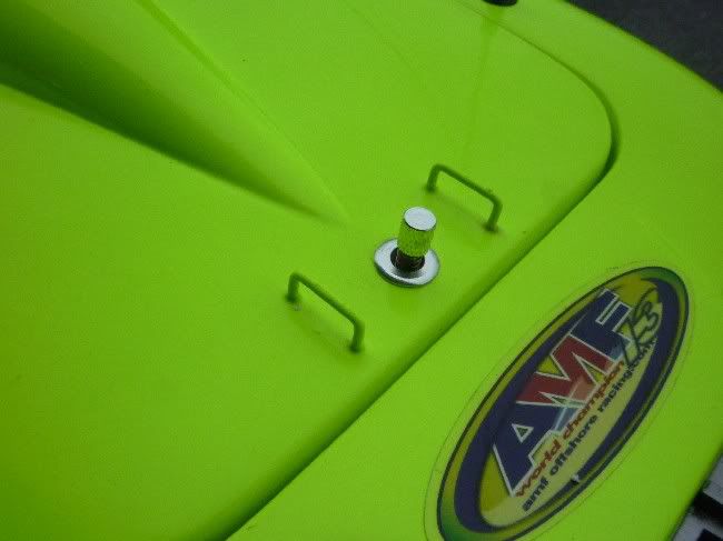

    Installed a Kintec Racing Push Button Hatch Lock. This lock keeps the canopy secured and will not come off.

    Dont you tape the hatch on?
    • wppracing
      • 109
      NO more tape. This works better

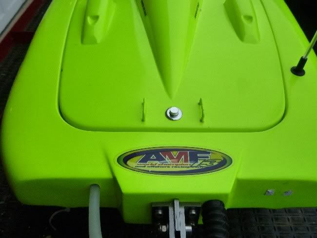

            I removed both magnets and installed my hatch locks where they used to be best mod for your cannopy ohh and don't forget to reinforce the cannopy with some fiberglass another great tip I learned

                I have the same thing on my MG and i still tape the hatch down just to be safe if it turns turtle the water will eventually get into the hull, plus remember all you have is a small pin in the front and thats just glued in place it could break free anytime and there goes ur hatch so i would and do tape the hatch down everytime
