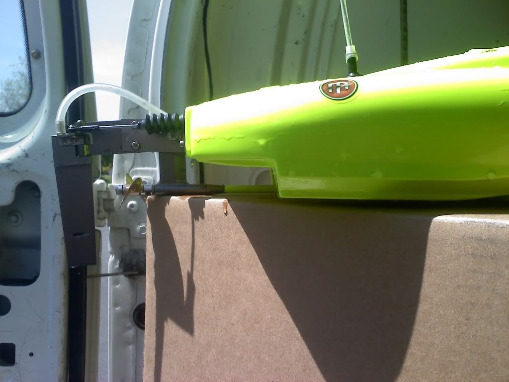

    some general info about my setup. im running a 42x55 grim racer prop sharpened and balanced, turnigy 5000mah 40c 2s.
    ive tried every adjustment i can think of and cant seem to get this thing to mellow out. ive read all the threads on it and tried everything but the offset rudder(though i dont beleive that is the fix for it). i read that the cob should be between 8-9 inches from the transom but for me the farther i put the batts forward, the smoother it gets
    any help would be greatly appreciated
    some pics of how things look as of today

                    Yes, battery forward of 9" @ center is key. Your strut seems to be about right. Looks to be level with the ride pads.
