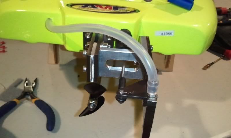

                      And last but not least can't forget my trusty flysky 2.4ghz $35 remote.... what a steal!!!! I love this thing[IMG][/IMG]
                      miss gieco cc 1518 62.1mph [/COLOR][/B] Delta Force 33" cc 1717
                      • bbosncali
                        • 756
                        Ill take it on her maiden voyage this week and post video mg vs spartan here I come shaun78 lol
