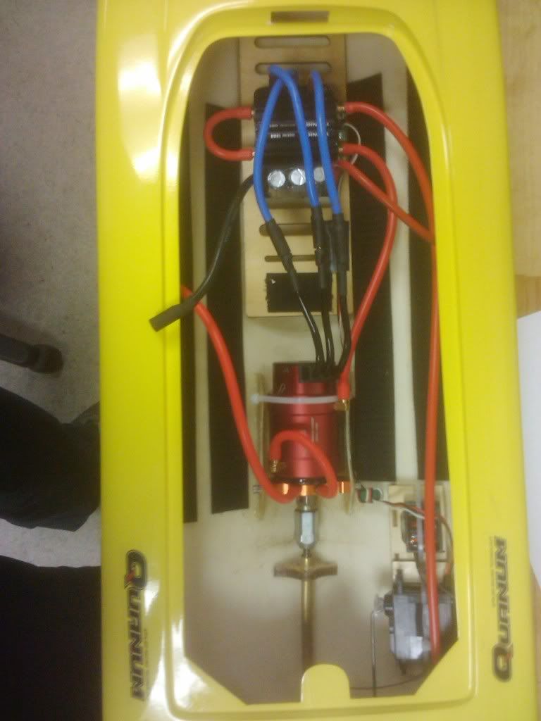

          Stay away from the "T" connectors. I understand your though process and idea, but don't use them in your boat. You would be better just connecting 1 side of the cooling to the other side of the cooling on the t180.
          [IMG][/IMG]
          - Diesel's Youtube
          - Diesel's Fleet
          • shannon87
            • 222
            thanks yer it was just to customise using the y splitters as the jacket im getting has holes for four connections and i thought it would look cool with two going in and two going out lol im just tryin to find little cool ways to add my unique touches i dunno theres somethin about the way a cooling system is set up looks cool to me
            • Diesel6401
              Memento Vivere
              • 4203
              I understand that, but "y" connectors normally do more harm then good. I would stay away, if you want to customize use different color cooling line and add a different paint job. At the end of the day it's your boat and you can ultimately do whatever you want but there are other ways that will be better IMO...

              • rchuntlsl
                • May 2010
                • 122
                Why do the Y connectors do more harm than good? I have used them and have not seen any problems. Just wondering, I may want to re route my cooling.
                • dana
                  Banned
                  • Mar 2010
                  • 3570
                  because water always takes the path of least resistance, meaning it may take one route over another in the "Y" and the other side will not get good flow
                  • shannon87
                    • 222
                    that makes sense maybe have one line goin in the esc and splitting to the motor goes into the motor then come out as two and back into one which shouldnt matter as both lines go into one source so it shouldnt make that much difference as the same amount of water should get there of course purely for aesthetics
                    • dana
                      Banned
                      • Mar 2010
                      • 3570
                      whatever you decide, keep it simple. function over looks
