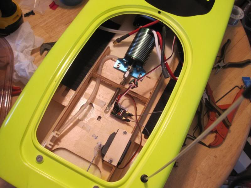

    Hi onegreenray,
    any pictures of the setup?

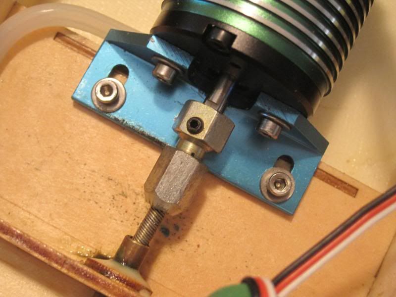

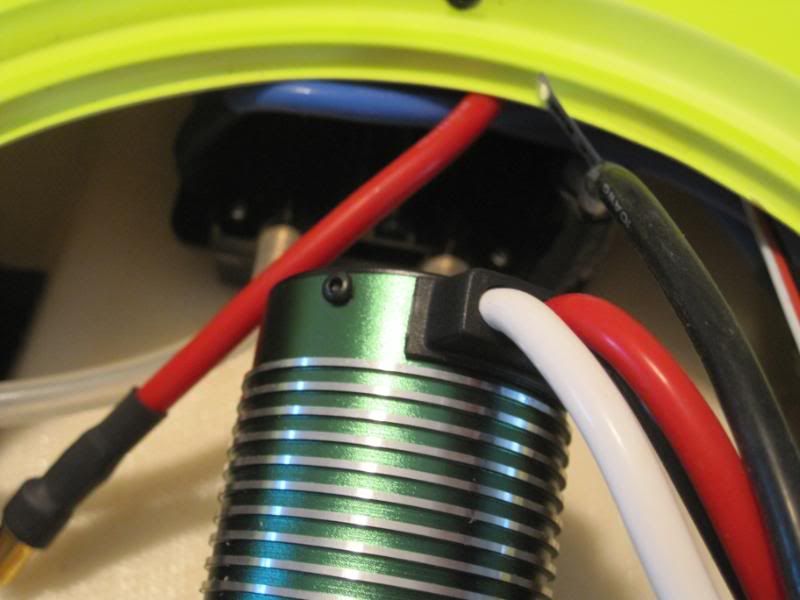

      since i took these pictures the wires i spun around so they are facing the hull now. reason being it was popping the Tupperware like seal up while running the boat.
