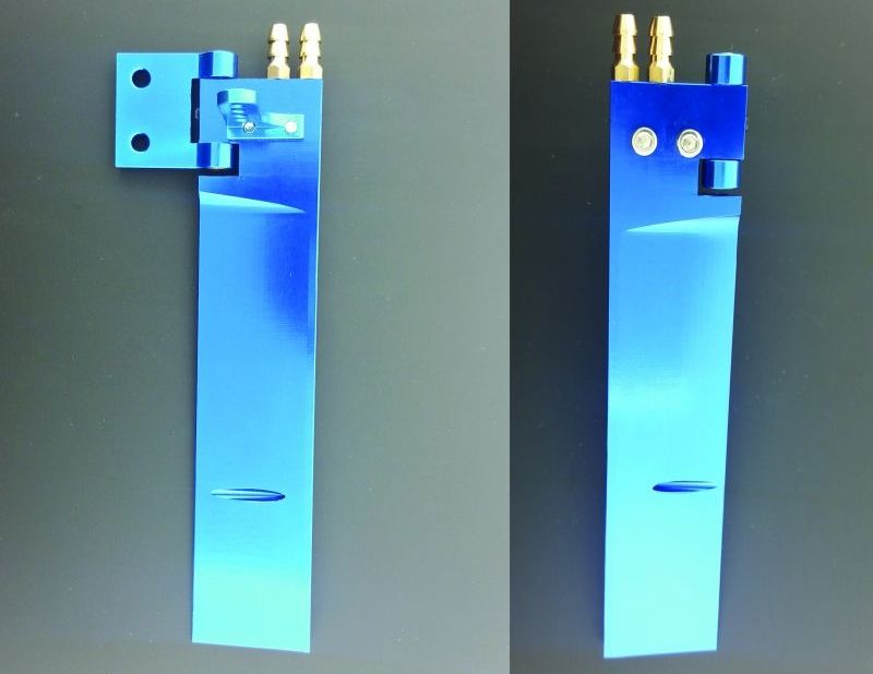

            Originally posted by fweasel
            New owner of my blackjack ran 59mph last weekend, motor and ESC were both under 110. He's switched to a wire drive and dual cooling rudder since I ran it last.
            You know what dual cooling rudder he used?
                This one
                Had to shorten it , open the hinge pin hole a bit then sandblast and paint black. Added an additional water outlet to the other side of the hull
                • REDLINE1
                  • Jul 2016
                  • 199
                  #23
                  Here's the link to my post on it
                  https://forums.offshoreelectrics.com...pickup-upgrade
                  Did about a 4min run temps were under 110
                  On both motor and esc. Took it back out to finish the packs off hit the lvc. Brought it back in motor was in the 130's and esc was mid 100 and teens. Lakes around here are still pretty cool so I'm not sure if the dual rudder is helping or not
