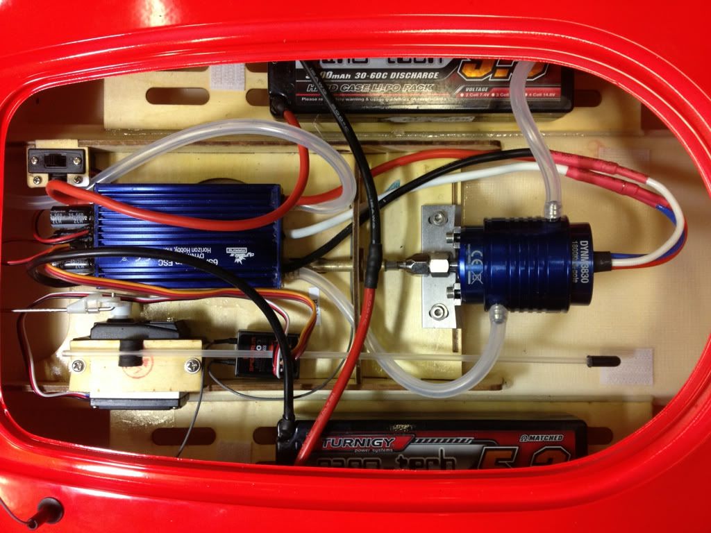

    Guys I'm a noob to the hobby. After a month of reading and learning. I order a BJ29. I ordered some Gen Ace Lipos and they come with banana plug charge lead.
    I figured since the boat has EC3 plug, I can get one of these EC3 to banana plug charge lead and able to use it. But this doens't seems to work. Turn switch on and nothing come on.
    I look at the adapter cable it seems like the polarity seems to be reverse from the banana plug to the ec3 adapter. Can you guys give me some pointer please?
    Battery:
    Banana charge + adapter
    Together
    Boat innard

        So I figured it out. The cable that I plug in original was just the adapter cable for the charger..
        I use the included cable + the adapter and got it to work fine.
        However I found it also needs to be angle b/c the straight plug wont fit inside the boat with the plug sticking on top of it. Guess time to run to the local hobby shop :)

          You'll find that most in the boat hobby don't use hard pack batteries.
          For one reason which you've noticed, the leads won't fit in a lot of cats. The second reason is that some think that they don't dry out as well as soft packs if gotten wet.
          Can you solder? If so get some 5.5mm bullet connectors for both the esc and batteries. They work best.
