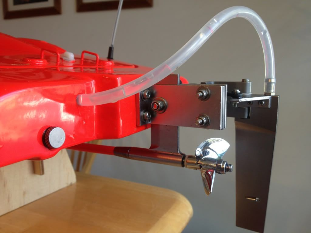

                            • tlandauer
                              • 5666
                              #74
                              Originally posted by AlanD
                              The good news: tlandaur, your silicon tube seal on the flexcable worked perfectly. I also removed and silicon-sealed the strut. Found some water leaks there. Not a drop of water in the motor or radio area now. Great pointer. Thanks.
                              The bad news: I fried the wiring going into the stock Dynamite3830 motor. Ran for 8 minutes on 6S/65C see saw runs. Minimal hopping and great speeds. Proboat says the motor is rated for 6S but that wiring is totally underrated for 6S.
                              I guess I'll be moving ahead with my leopard 4082 upgrade sooner than expected. Olwardbirds, what motor mount did you order from OSE for your Leopard upgrade?
                              [ATTACH=CONFIG]96502[/ATTACH][ATTACH=CONFIG]96503[/ATTACH][ATTACH=CONFIG]96504[/ATTACH][ATTACH=CONFIG]96505[/ATTACH]
                              Good to hear the water issue is gone, 8 min. run is extremely long and on 6s it is not surprising for something to fail. Assuming that your run was continuous. The wiring and especially the plugs are always a joke to me, anyway.
                              For my curiosity: does the motor still turn or it is completely dead? I can see the insulation has suffered hight temp.
