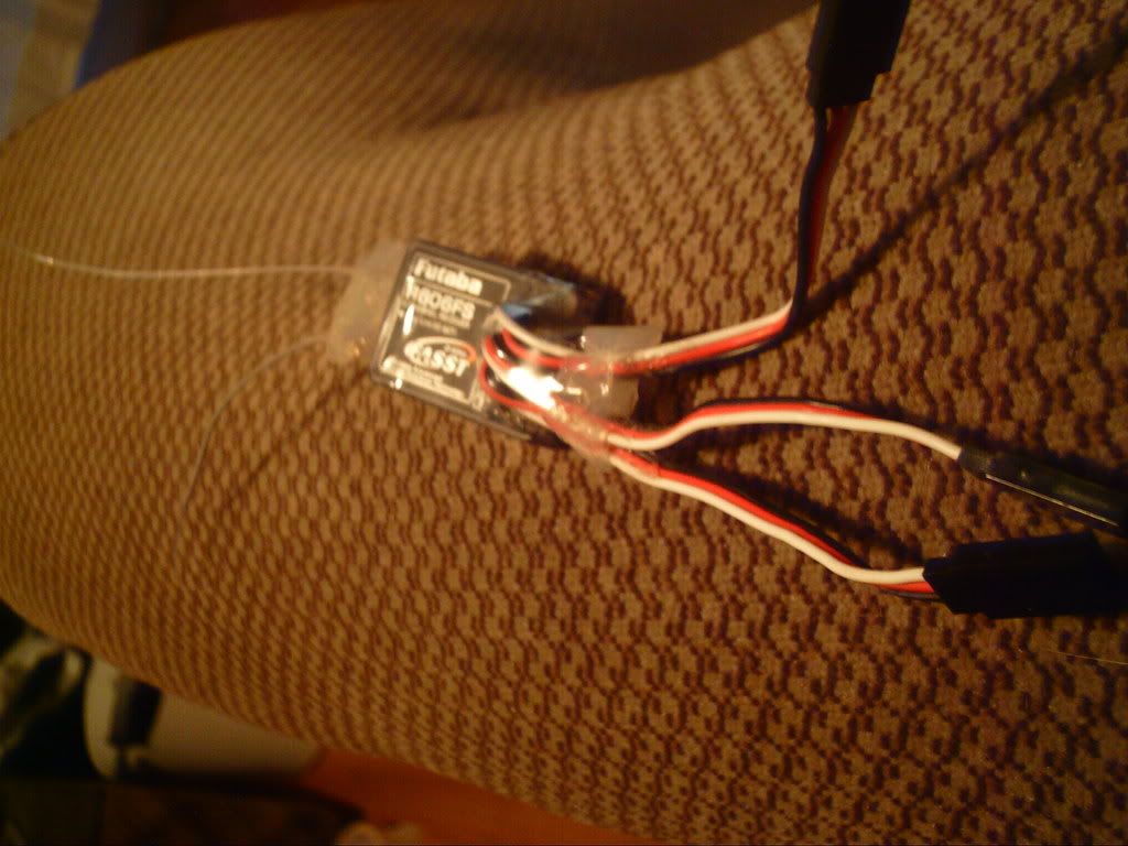

                          I sand the fairly sharp corners of my 606s to as large a radius as I can without going through the plastic, bind them, fit as many short servo extension leads as I am likely to use with that RX then put an oversize length of heat shrink on, squirt a plug of electronic grade silicone sealant around the wires near but not touching the case I then wait 24 hours for it to cure, trim the heatshrink to length and use it safe in the knowledge that if it gets wet its not going to damage it and should anything go wrong with it the heatshrink and silicone can easily be cut off so it can be rebound or go in for service.

                              I strongly recommend that you do NOT do this to any FASST receiver. Simply spray it with CorrosionX and let it be. 2.4 RXs tend to build up a bit more heat so sealing them up tight is not a very good idea.
                              If it gets wet, open the case, blow it off with canned air, spray it with CorrosionX again and you are good to go.
                              I have dunked these receivers more times than I want to admit and I have yet had one damaged.
                              If they get wet all they do is lose their binding with the TX. You will see a solid red light. If it happens while running the RX will just go into failsafe.
                              But please, do not seal them up like this. You will possibly do more damage then if it gets wet.
