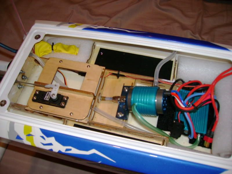

    Just finished installing the fuller's cat hardware on my blackjack. Let me know what you think

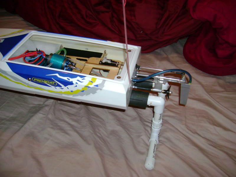

    The yellow thing in the back corner is the RX, and I've moved the ESC up in front of the motor like several other guys have done. Regarding the batteries, how many of you are just placing them in the "stock" position. Also, TXboatpilot, anything pointers on a sweet spot set up for the fullers hardware? I noticed that my hardware is different from yours, and the propeller is set further back away from the boat than yours or anyone else's. Is this going to affect performance?
    I'm going to run her tomorrow, so hopefully i will have some better numbers on the GPS than i did with the stock hardware.
    Also, I have an extra sv motor lying around, and discovered that the octura coupler it has on it is too large to clear the motor mount. Any ideas on how to solve that problem? I'm not really sure that I can get the coupler of the SV motor because the grub screw is stripped...something i did before i knew any better. I'd like to use the octura, as it is more robust, but it just won't clear the motor mount.

    Looks great! My hardware is "like" fullers, I did not acually get it from Ray Fuller.. I would start w/ the strut level or 1mm above level with the sponsoon bottoms.. Not really sure what you are asking about the couplers??

      RX?? looks good, your GC might be a little forward but if you play around with the batts it should run sweet, what did it cost you for the fullers setup ncluding the flex system?

        apples1, i assume are you asking what kind of rx it is? it is a hitec agressor 2 fm system. the receiver, conveniently enough, is completely compatible with my futaba magnum 2pl fm radio, which has something like 10 model memory, so as soon as i get around to buying a radio crystal for the channel the futaba is on, i will be using that transmitter. the fuller setup was about 100bucks, just like it says on the website, and it comes with the flex cable. all I had to do was drill two new holes in the hull for the mount, and cut down the flex cable. not difficult at all.

                    just ran my blackjack after installing fuller's cat hardware and got a whopping 29mph on the gps. i know it is installed correctly and is free of any binding, but from there i'm clueless about cats. any pointers on setting it up correctly for more speed? i know this thing has got at least 40mph without any other upgrades. the batteries were placed in their stock positions (6 cell GP 3700's) and the speed control was mounted in front of the motor as per some other people's set ups i have seen. I did notice that another person's boat, when still pictures were taken in the water, sat much lower at the stern. my boat was basically level, which i assume means the first thing i should do is work out the CG. Other than that, any pointers? Oh, the prop...the only props I had to work with were the Graupner CF props, and decided to prop conservatively with a CF 40, although I have a 42, 45, and 48 as well. Can the BJ take a CF 48 without overheating everything? The strut was set lvl with the bottom of the sponsons, should it be higher, lower? any adivce?

                      The pictures you probably saw were of my boat. When I am running my boat for pure top speed numbers, my batteries go all the way to the transom. I also run a slight bit of up angle on the prop. But with your prop being further back from the transom, you may not need as much. You will simply have to try some different settings with your strut to see what works best. I started neutral, then when down, then up and finally trimmed the prop up slightly.

                              Zero, your main problem right now is not your center of gravity, if your prop is more than an inch or two behind the transom, your strut height needs to be above the bottom of the hull. And when we refere to strut height, we mean the bottom surface of the strut in relation to the imaginary line that would be if the boat hull was sitting on the table and what happens on a stepped cat hull is that it sits only on the tips of the steps...that is basically the running surface, and should be used to eye up your strut height.
                              Remove your prop, and spin fins if they're still installed, then set the boat on a table or other flat surface. Loosen the strut adjustment bolts and slide the strut up so that the bottom of the strut is about 1/4" off the tabe, and level with the table. This should be a starting point. The 40mm prop should work fine to get atleast mid 30s. I have run an octura x440 with batteries in the stock wooden trays with the strut set level with the bottom, and run over 42mph. Thats on 12 IB4200 nihm cells.
