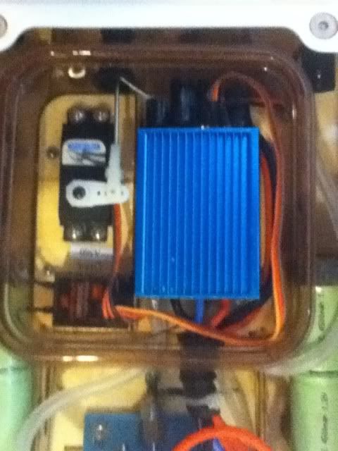

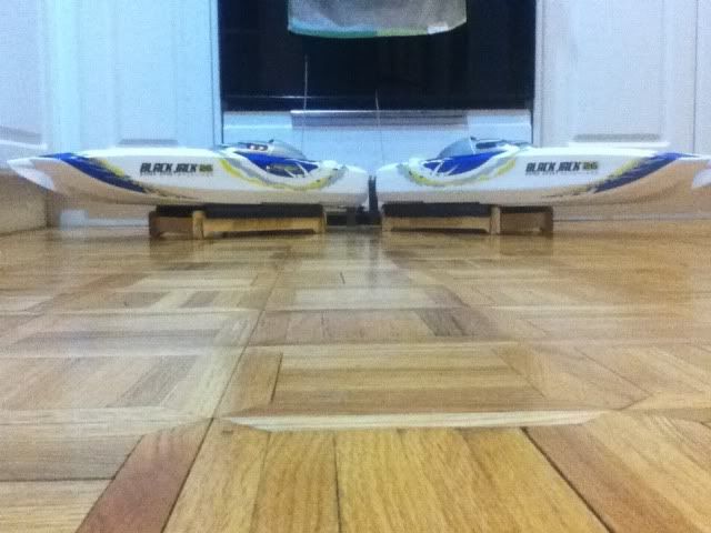

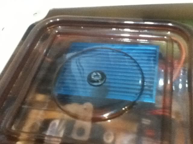

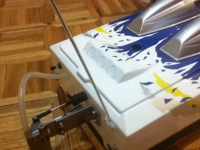

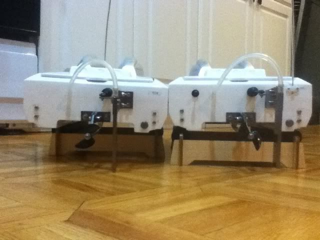

    I got mine about 2 weeks ago and when my dad saw it he decided he needed one so his came in about a week ago. We ordered the dupro switch and antennea mounts. So far ive only done mine (still have to patch the antennea hole in the canopy, or get a nice one from tiqueman), I'll do his soon. Here are some pics

    It's a very good idea to use a "break-away" screw on the bottom rudder mount in case you run over something underwater (branches, logs, turtles). It will "break-away" and pivot upward, preventing or at least minimizing rudder and transom damage. Like this

      thanks for the tip, may have to order some!
