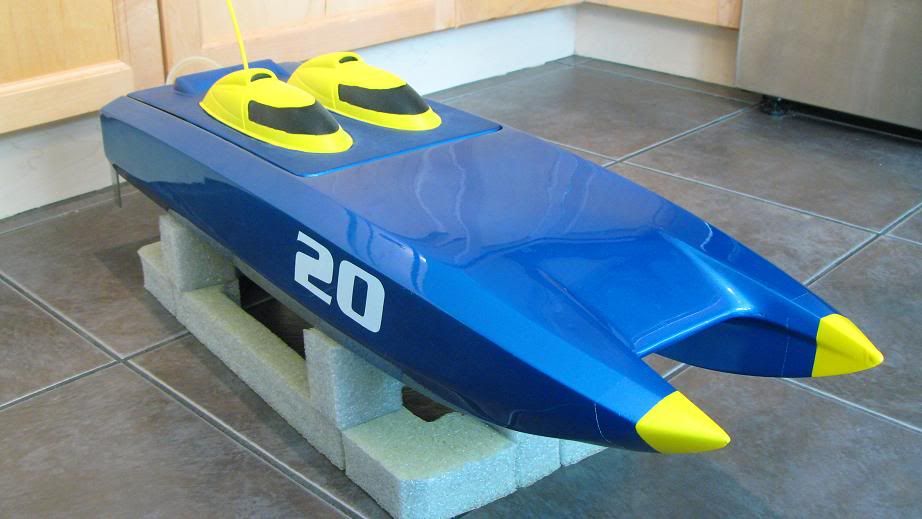

    Hey guys,
    Just finished putting clear coat on the yellow tips. Nothing too crazy...wanted the scheme to be simple...
    Currently has the following:
    Stock 1500KV motor
    Stock Prop
    Stock Running Gear
    90A Seaking ESC
    Thanks to all the nice folks here at OSE, I'll run'r with 4s and then when I get used to the speed in the turns...6S
    Go Brushless or GO HOME

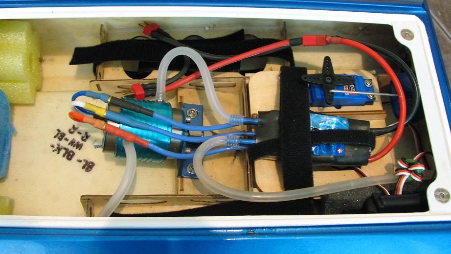

              No i could not keep it on the water running 5s all the time. I had to upgrade to a rudder and solid prop strut. The BJ26 SS Nitro hardware fits right on if you have a .150 flex (stock flex) without the universal joint. Talk to Steve hes got them in stock you have to cut it to length but its works better then having the u joint. Only reason i liked the u joint is i could control the prop strut pitch more. lol to much and it will do a back flip. I also added another water pick up using the stock prop water pick up setup.
              These pictures are kinda old and i have not updated to the second water pickup yet, also still using the u-joint in the pic. Ill update in the morning when i can get my camera out of my truck!
              I believe it's my god-given right, To destroy everything in my sight. Cause it never gets dull, it never gets old. The only thing it gets is more bold. Drinkin', fightin', going to the game. In our world it's a way to stay sane. If you're asking me. To have it my way, I'd say that's One fine day. ---- The Offspring
              • WrknItUp
                • Jun 2010
                • 338
                Okay a few updated pics..... Dont look much better but runs like a scolded dog turns like a fish.
