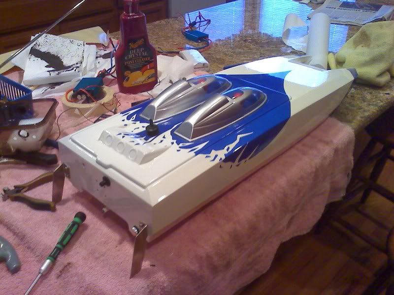

Time to give the Blackjack some attention.
  • wakeboardfusion
    • 462
    Ive spent so much time on my dumas sk daddle build in the builds section, that my cat was lonely. I decided to take the stickers off, polish her up and let her wait for her makeover. The plan is,
    Remove battery tray, and radio box.
    Either Fullers or aeromarine hardware. Or could go with the FT hardware.
    I hear the fullers sometimes makes it slower than stock? That true? I want to have a stable boat and not have it blow over any more, and i hear the fullers accomplishes that. I couldnt find much on the aeromarine stuff, any reviews?
    90-120 amp Seaking ESC, 2nd Proboat one is giving me problems again.
    Traxxas waterproof Servo
    And i wanted to get two 3s 5000 batts, but do you think that will be overkill?
    Maybe 2s is will be fine, or i could mix a 2s and a 3s. Any thoughts?
    EDIT: after adding up all costs is it worth it to upgrade, it would be around 250 to do all that. I really want one of the micro hydros salir has. Oh well.
