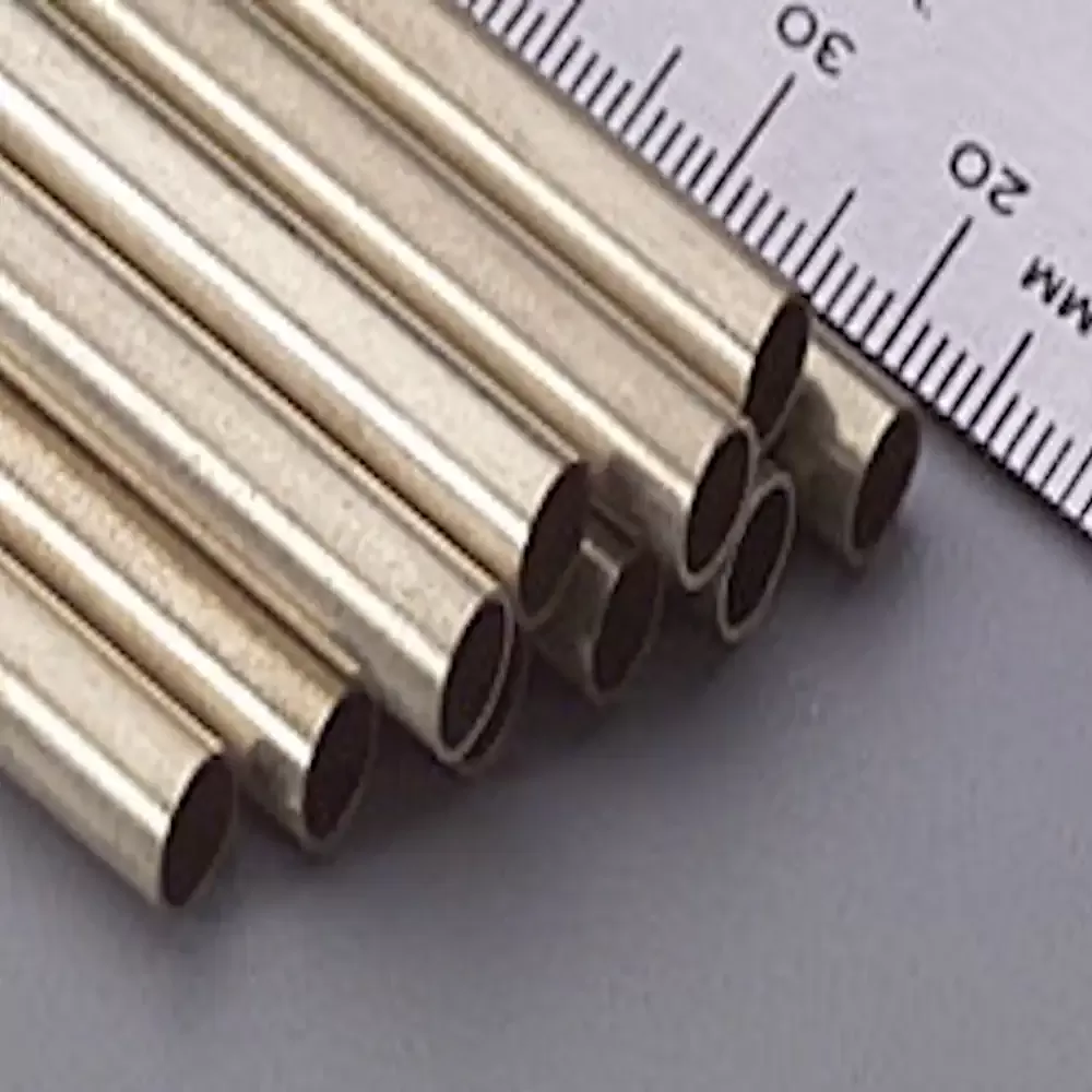

    Can someone tell me what is the stuffing tube dimensions of the blackjack 24? I'm using the upgraded strut and cable system sold on ose. The cable is a .150 with a 3/16 shaft (using teflon liner). Or what size stuffing tube do I need for a .150 cable? Thanks

    Check the brass tubing listing on ose.

      Thank you. I did check and it says 1/4 inch tube but what I'm worried about is will that 1/4 inch tubing fit the leading edge of.the strut of the blackjack 24?

        Proboat often uses metric sized stuffing tubes and teflon liners, which can be a hair different than standard sizing K&N is most commonly sold in. I like to have a mix of everything on hand when I'm customizing parts like that. I get the metric stuff on Amazon or eBay.
