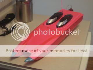

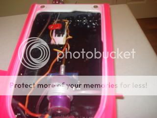

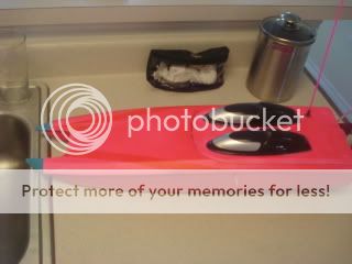

                          well diego here you go. OH and i figured since i will probably be a fembot when i get up there i painted the boat accordingly lol.
                          • Diegoboy
                            • Mar 2007
                            • 7244
                            #28
                            Nice! She will surely fit right in.
