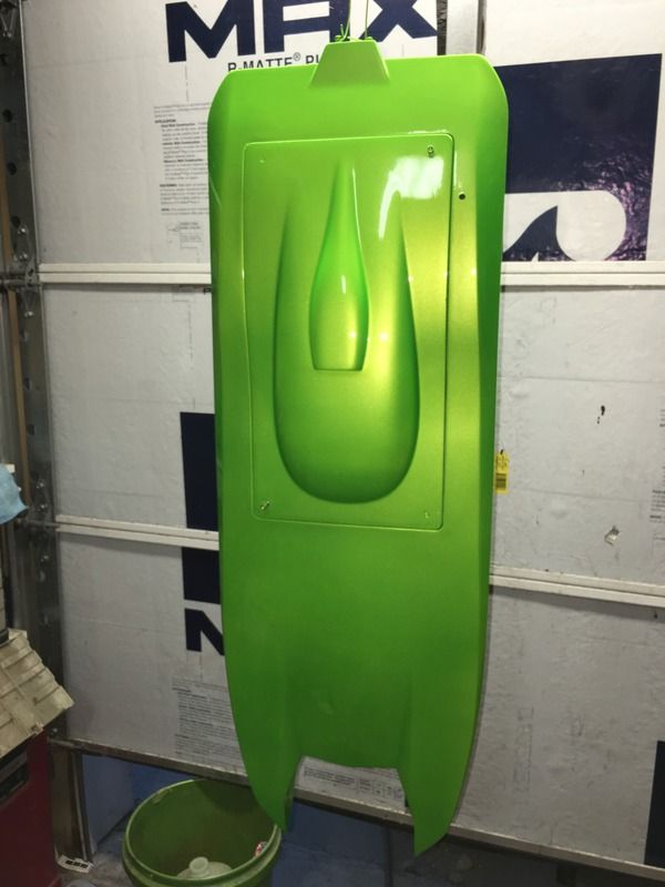

                  Three coats of clear this evening before sun went down. After that the bugs would be out. Soon as I was done with coat three, the lights were turned out and shop locked. I snapped a pic right before. I just can't pick up the color correctly in this light. It's so beautiful.

                    Nighty Night Sweet One...Sweet Dreams of 90+ Mph !!
                        That is a thing of beauty!

                            Sunlight will wake it right up. Looks like it has a gold undertone. Any opinions on colorshift?
                                That's going to look sweet with black Zelos decals
