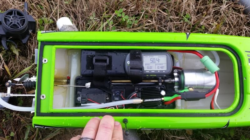

                        Originally posted by RCBoaterGuy
                        Set mine quite a bit different than that... see attached - pix taken just before maiden run. Was easily doing the same speeds as kfxguy's green machine in stock trim - 28~30mph on glass water.
                        ESC has been replaced with Turnigy 120A I recommended in earlier post - last night installed Castle 5.5's for motor<->esc & EC5 split tops for the batt. Got some clear RTV from the maintenance guy @ my apts earlier today to fill in the open area where the motor wires / water pipes come out. It was stone cold, have to wait overnight to get to room temp. Will take before / after pix tomorrow.
                        Motor is going to PB-1800Kv (gray can & cooler) from IM-31 attached to hull with IM31 motor mount & connected with Octura 5mm->.150" short coupler.
                        Prop was stock plastic - now optional stainless S&B'ed. Going to experiment with other size's on third run. Second run will be test new setup.
                        Prop shaft + bushing polished per instructions above.
                        Water lines are Prather... http://www.funrcboats.com/ProductInf...tid=LARGEWATER
                        Servo = Traxxas 2075 high speed, high torque, ball bearing. Hold down strap = home made from K&S stainless stock. Rudder pushrod was IM31 cut down - now home made, HOR racing 120mm dual threaded 2mm rod with blue DuBro ends.
                        Receiver = Tactic TR-624 water proofed with this stuff... http://www.plastidip.com/home_solutions/Liquid_Tape - see attached pix - balloons are bad, attract condensation, condensation is bad.
                        External antenna's create drag, drag slows down your boat. Antenna hole plugged with epoxy.
                        Hull - mixing cups arrived today, now can finish filling the front with foam to make it stiffer - will take updated pix when complete.
                        Summary, a boat that goes fast & handles good is the product of attention to the details, not the one with the biggest, baddest most powerful motor. Doesn't matter if it's a plastic RTR or a Revolt 30 / IM31 / Lucus Oil / UL-1, etc etc.
                        Hope that helps...
                        did u open up the receiver to treat it. just trying to understand what i see in the photos

                          #27
                          Yes - the 624's have 4 tabs, 2 on each side - see attached - I drew a line to the top 2. Use small jewelers screwdriver - start at one corner & work my way around. Reason for the 6-chan rx's is cuz they have short external antenna, lot cheaper too - get'em for as little as $10 shipped. -- 324's have internal antenna only, I've had too many issues with them on water, work great on land though.
                          Clean the circuit board with denatured alcohol to remove any solder flux residue that might be on it from touch-up work done at the factory. Then clean with Ajax dish soap & hot water, blow dry.
                          Harness was made with wires from servo's / ESC's that went bad. Cover the 2 outside pins & every other in the middle, wrap a layer of electric tape around them to keep the coating off. Hook a paperclip through the top to hang it up.
                          Do three layers... first is lite, let cure for 4~6hrs. 2nd coat little thicker, cure overnight. 3rd coat is thickest, then cure for a couple days.
                          After re-assembling, put Testors Window Maker glue on the tabs to keep water out. Cover the top 4 sets of pins with a layer of electric tape, glue it down. Look @ 2nd pic in post #25, double click it'll go full screen, take a look @ the Rx, you can see the ports that have been covered.
                          First one I did is in the Tower Hobbies boat referenced in post #11. Like I said in the post, boat rolled over, took on a lot of water. Drained it out, put the boat back in the water & kept on goin.
                          2nd is in the SW26; it too got wet on the maiden run, again no issues - motor cooler was leaking a bit that's how the water got in.
