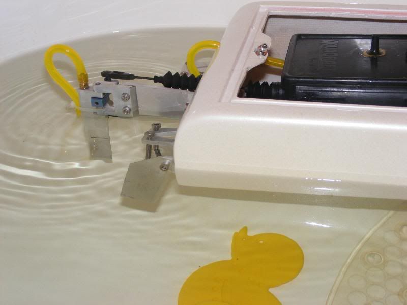

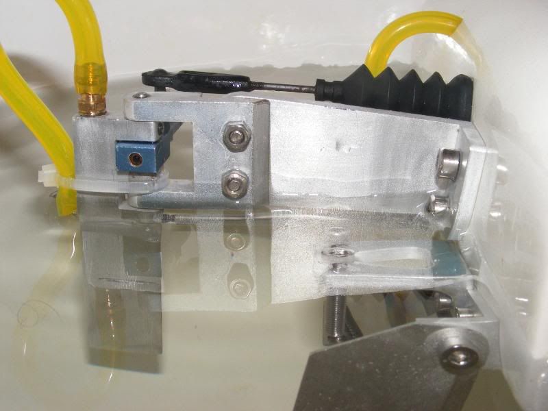

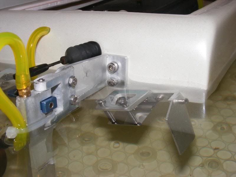

    Is it me or is my SV sitting too low in the water??
    i did a float test it the tub tonight to check if the boat was sitting ok cause i moved the batteries up alittle bit andmaybe its just me or is my boat sittin really low???

    Looks like mine bro!

        looks right to me, ps use a antenna cap over the stock water pickup. it will stop the water from flowing thru and causing drag

          Why do you guys that run 2 pick ups.. Not take full advantage of the first/stock pickup!?
          If i had 2 pickups, my motor would have a fresh source of water and so would my esc.

              that stock pickup sucks. it doesnt pump water in the staights and only a little when turning right. the traxxas pickup flows so much water its un neccesary to run two. i was going to run it to the esc but dont want to chance overheating it ( i run 5s regularly on stock esc) havnt had a prob with the single traxxas pickup
                Hey! Where'd you get the new rudder?

                  I doubt this guy will answer you, but this looks like the stock rudder with the blue anodize removed

                      Oh I thought it was an upgraded rudder. How do I remove the blue anodize? Does it improve the performance?

                        I used regular oven cleaner on mine just spray it on( remove the hardware from the boat of coarse) and rinse it off it may take a few times but it will get it off. It seems this guy owes people money and or merchandise, I guess when this sort of thing happens people convenietly die

                          Oh alright sounds cool. What do you use to make the back of the boat water tight? Sometimes I feel like the water comes in through the back such as where the rudder rod goes into the boat. I was thinking of putting epoxy on the transom from the inside. Good idea?

                              the water is probrably coming in from your hardware as mine did.Remove your hardware and put a bit of silicone under the hardware and remount, this worked for me.Another thing i have added is an autobailer that you can get here at OSE this will help get water out of your hull if it does get in.
