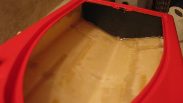

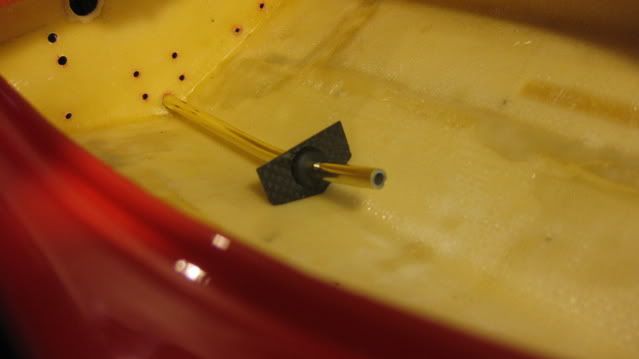

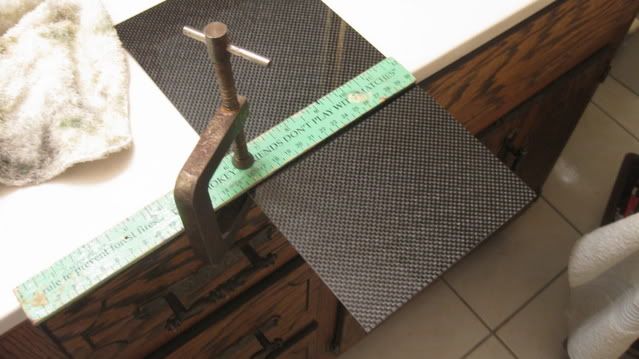

                            Ok so Iv ordered a Feigao 540 12L, Im just going to set the boat up
                            the way I want it to try and run 50's, but just to have fun Im alittle
                            broke so Im gunna try the 12L with the stock esc and Octura X438 on 4s, maybe
                            ill see high 40's with this setup for now.
                            I have cleaned the hull out and layed down carbon fiber in the rear of the hull,
                            and made a small mount to hold in the drive shaft down. Everythings going slow for now
                            but Im stoping by the Hobby lobby in a few to pick up some birch wood to build the
                            motor mount. Ill have more pictures up late tonight.
