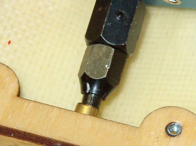

    I just got my SV27 today,and have spent all day,adjusting the trim tabs(cutting the holes ,into slots) so I can get them flush to the hull bottom.Checking for kinks in the water lines,changing out the radio equipment,putting foam in the antenna hole,and flotation in the cowling. While I had the trim tabs off,I used some silcone caulk,and sealed them (there wasn't anything from the factory. I went upstair and filled the bath tub and gave her the leak test. She FAILED miserably! It is leaking (fast) where the brass drive tube comes through the transom. Should I mix up some epoxy and fill/glue the opening shut,from the inside? Or should I unbolt and remove the (drive tube,I don't know the right term for it) and apply silcone,between it and the outside of the transom, ( like I did the trim tabs) then bolt it back up?Any Help will be greatly appreciated. Ron

    the tube should already be epoxied in.
    Its just sitting in there?
    Its not attached to the boat at all?

      Well,it's NOT.If it is, they didn't use enough epoxy to seal it (I don't see any).I figured it was sealed from the outside (like I had to do the trim tabs). I mean the water REALLY runs in. I didn't have the boat in the water for more than 5 seconds,and already had around 3 oz. of water in it. The leak was very easy to spot. I'm starting to think the term "RTR" means (ready to rebuild). There wasn't any sealer ANYWHERE on any of the hardware on the boat sofar! They need to sell this boat as a ARTR (almost ready to run) Kit. Apprently your gonna have to remove the hardware,cut slots in the trim tabs, to get them flush with the bottom of the hull,seal,and loctite (they did use thread locker) all the hardware. It would be just as easy to assemble it in the first place,and have it done right from the start. I'm sure I'm gonna like the boat after all the bugs are worked out of it. That didn't answer my question! Do you epoxy,the inside,or use silcone on the outside,between the hardware?Ron

            yeah the stuffing tube deffinatly needs to be mounted and solid.
            Sounds like youve got the problem sorted out

                #1 Replace the stock stuffing tube and slot the wood for the motor mount. This is becouse the factory does not align the motor to the stuffing tube very well.
                They also leave out alot of teflon. Mine had apprx 2" in it. Get some for .150 cable from Steve.

                            Agree about using new tubing for the stuffing tube also I lined it with new teflon. My stock stuffing tube could be spun around with my fingers! Wasn't glued in at all. Make sure you pressure test the coling (mine leaked at the nipples that attach to the speed control. ) Align the new stuffing tube perfectly. Leave a bit of a gap between the drive dog and the strut. Tape the hatch down good and let her rip. Mine with lipo's and a stock prop runs 38 mph.

                              motoxbob11,Thanks for the tip! I'm taking the ESC out today and checking the fittings. I also found my drive coupler(I think that's what it's called) is cracked. I guess it will be alright to run for a while (first few runs) it tightens up ok. Ron
