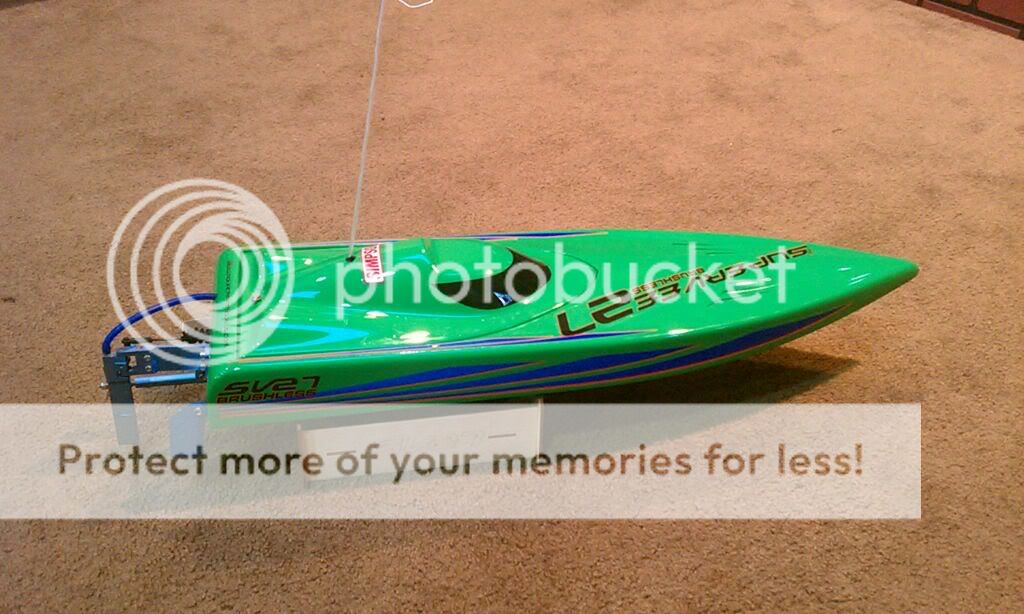

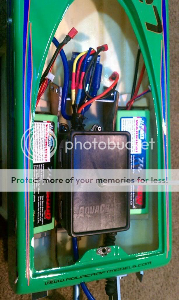

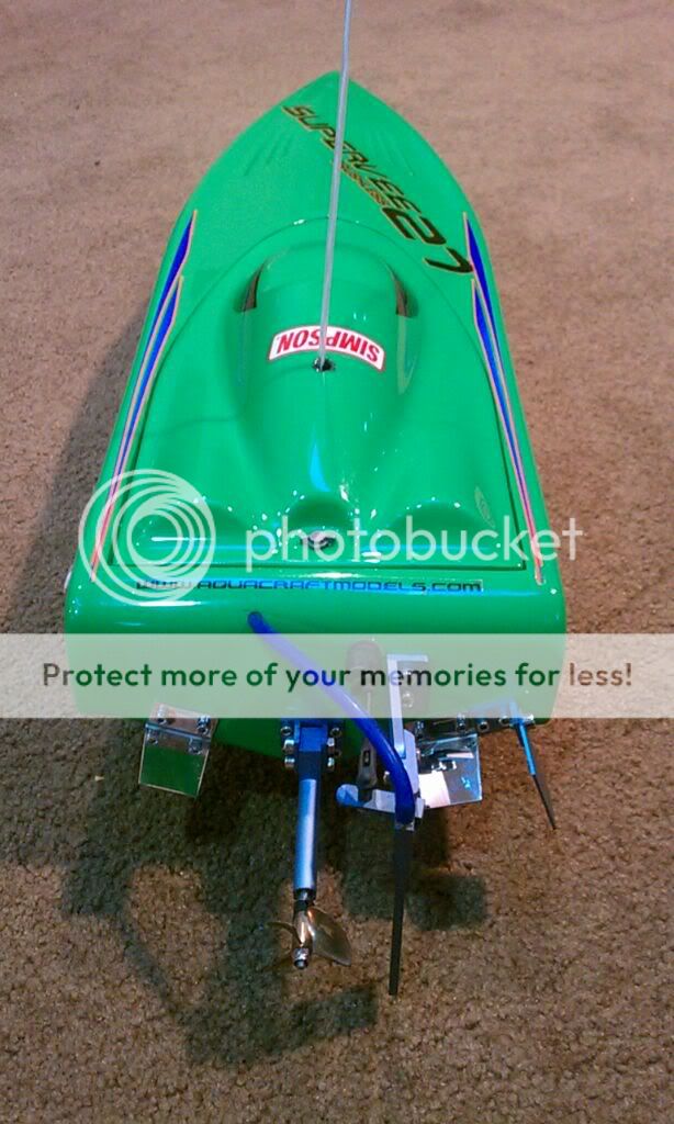

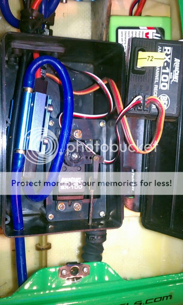

                      OK I water tested the boat in the tub and it leaks. I don't even know what the L shaped taps are called on either side of the rear but the screws on the right side are leaking. I can not find any markings on the prop so I don't know what size it is. I attempted to post photos below I hope it works.
                      • Make-a-Wake
                        FE Rules!
                        • 5554
                        Decent looking ol' boat there.................the "L" thingys are trim tabs, they are to be adjusted up or down the get the boat riding level. The Reciever looks ancient, get yourself a 2.4ghz radio, they are becoming very affordable now.
                        • magnumdivr
                          • Mar 2012
                          • 9
                          If its the trim tab hole that's leaking how do I stop it?
                          • BHChieftain
                            Fast Electric Addict
                            • 1964
                            You can use silicon sealant if it is just plugging/sealing the hole. But only use it for things like this as the fumes generated when it cures can corrode electronics.
                            If you had a big crack, you would use epoxy or fiberglass cloth + epoxy for repairs.
                            Chief
                            • siberianhusky
                              • Dec 2009
                              • 2184
                              Don't use silicone, use one of the latex sealants like Mono. Silicone gets into the surface of the gelcoat and makes repairs very hard as nothing bonds to silicone. Even paint will fisheye.
                              You can never fully remove the stuff.
                              You should take all the hardware off and put some sealant behind it, avoids problems at the pond when you find something else is leaking!
                              Happens to all fiberglass boats, no big problem.
