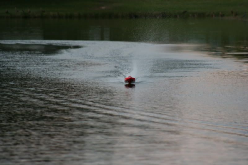

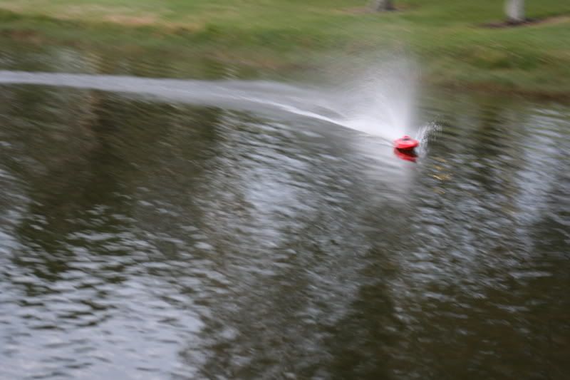

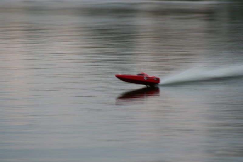

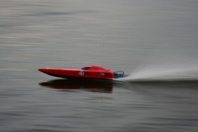

    My SV in action
    just some quick pics from the other night.
    SV27 race prepped, stock motor & esc
    two 7.2 3000mah venom batteries
    JR radio equiptment

    Wow! That looks good. What kind of prep work did you do?
    What prop?
    Government Moto:
    • Avanti
      • Nov 2007
      • 1280
      all the hardware was removed off the transom adjustments were made and they were reinstalled with silcone. the hull was blue printed, and the c/g (balance point) was adjusted (the battery boxes were completely remove in favor of velcro, and the c/g is about 3" fwd of stock). those pics were with the grimracer 42x55 two blade metal prop

                    The boat in those pics are running with crappy venom 3000 6 cell ni/mh batterys? WOW!!!! I have an old set of those and my SV shuts off from low-volt cut-off or something if I go over 3/4 throttle and mine are rebuilt s x s with deans connectors, noodle, and bars. But your boat seems to be going pretty well. Pictures are decieving though. Lets see some video!

                      The shots look great, but how did you get it up on plane with the Venoms
                      Otherwise, great looking boat, great looking pics

                        my venoms no longer works, they lasted about 20 runs now they are junk.
                        my trinity 4200s are also on the way out I have one dead cell out of 12.
                        I am going lipo but it will be a while before I can fund it.
