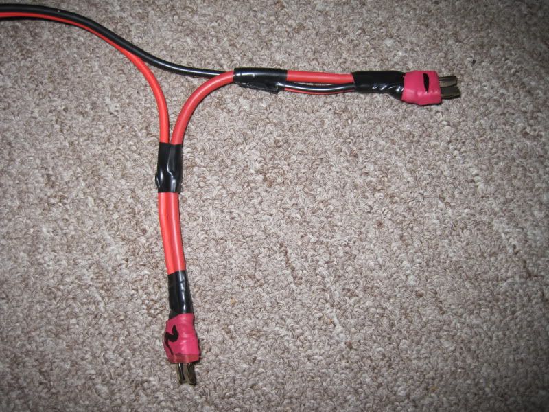

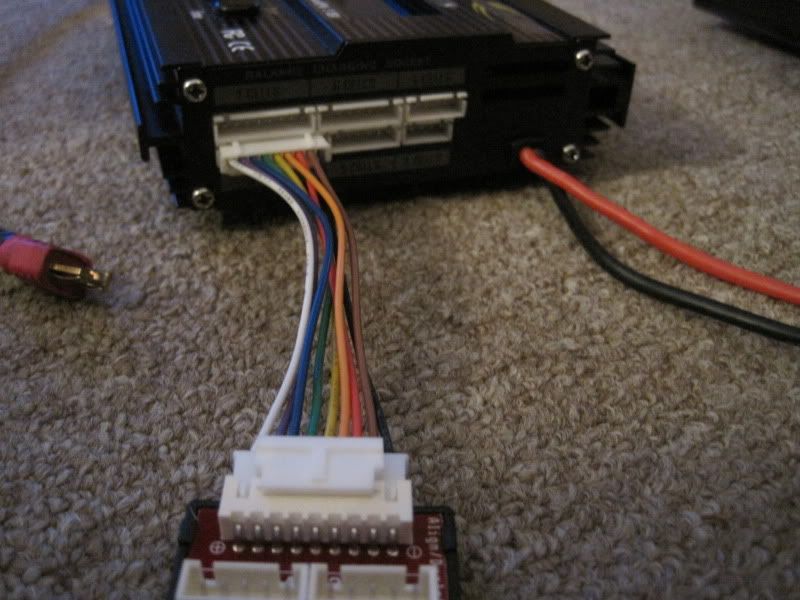

      hey wizard:
      here is the end product:
      thank you for all your help.

          Your setup looks great whats the part # for that balancer you got I want to get one. Yes you can get carbon tape from Kintec use some of that blue masking tape to work with it and some 3M #77 adhesive to tack in place and. It frays and comes apart easy the 77 should hold it in place then lift off the tape and use Z-Poxy on top works great. An old credit card works great to smooth it out. good luck Wiz.

            the adapter is from the link you posted for me earlier in this thread from helidirect.
            • wizard122
              • 483
              #36
              Thanks the photo at Helidirect dosn't show the 2 4S ports thanks. so it will charge 3X2S 2X3S and 2X4S is that right?
              2 SV 27's and Vac-U-Pickle UL-1 Power
              • onegreenray
                • Jun 2010
                • 213
                #37
                yes that is right.
