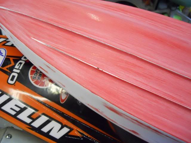

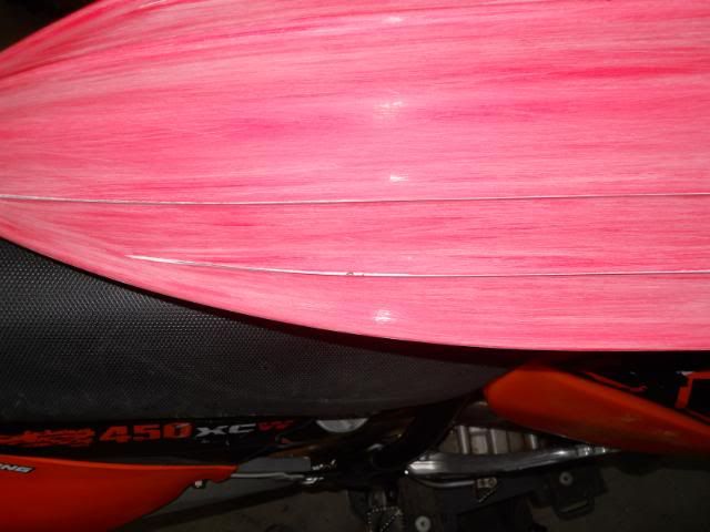

    I have totally striped down the hull and started to sand in preparation for a small repair and most importantly to get rid of the red. When I started to sand the bottom I noticed a couple of pin holes, and I do not even know where to start to fix. Can some one point me in the right direction... Thanks

    I used Z-poxy to repair a large hole in mine and it worked fine so I am sure it will work fine for the small holes as well. I hit the fountain in the middle of my lake and crushed the front of the boat.
    I mixed up some zpoxy and just poured it into the boat and hung it up so the epoxy would get into the holes. I taped it up from the out side to prevent a mess on the out side and it worked pretty good. After it dried a day I repeated it twice to make sure all the holes were plugged.
    Next I sanded the out side and painted!
