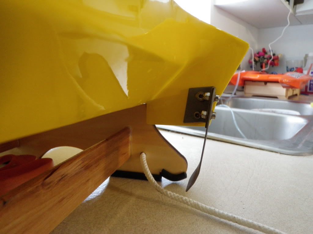

Back to the water inside the hull. After inspecting the hull. My heart dropped to see how weak the UL-1 is in the turnfin area. It was already starting to hair line fracture. Just like the pictures of other ul-1 users (a guess "crash" talks about it the most =P ). But I did not crash the boat.
After that first hair line fracture started. I tried to support/seal it with some 5min epox. But there was no stopping it, unless you take the fin off. With the fin off the boat is very usable in turns.
I am guessing that I got a boat that was shipped before 06-15-09, and does not have the update hull. Good deal gone sour quick.
Not too sure what to do now. It seems other people cut there hulls out and try to support that area? Found that here ( http://forums.offshoreelectrics.com/...ead.php?t=8614 ) Buying a new boat? It does not seem like a new hulls are available?? found this site. ( http://kintecracing.com/UL-1_Upgrades.html ) from here. Ordered the Super Duty Turn Fin Bracket, and Rubycon Capacitor to protect that speed control I might want to update if I can get the that part of the hull to hold up.
That area seems to be stronger on the miss vegas deuce. feels Solid when I give it some pressure with my finger. The Ul-1 feels paper thin in this area.
