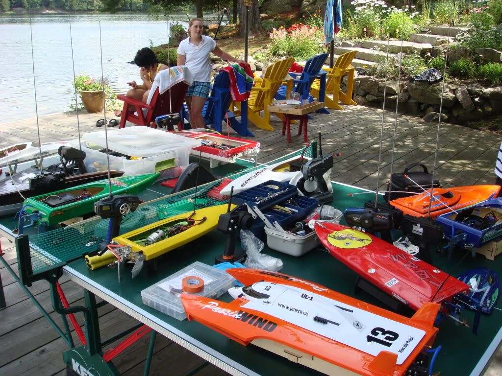

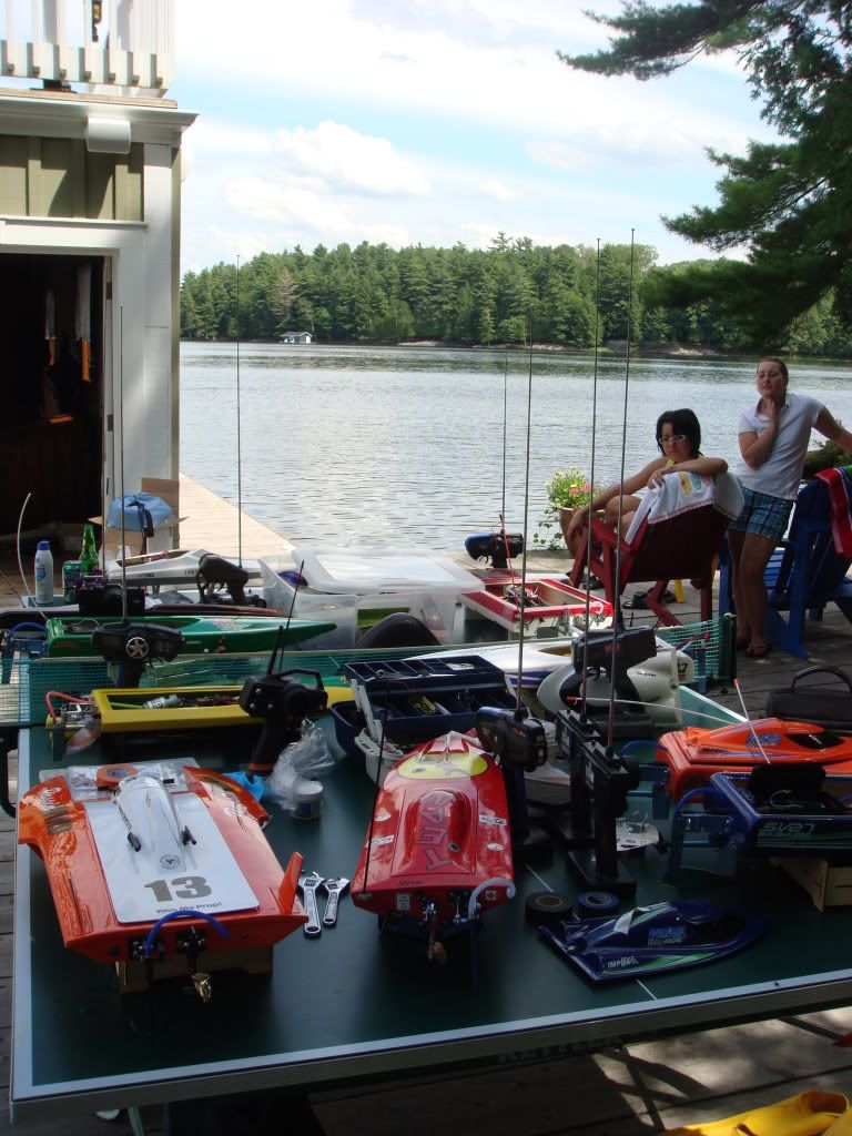

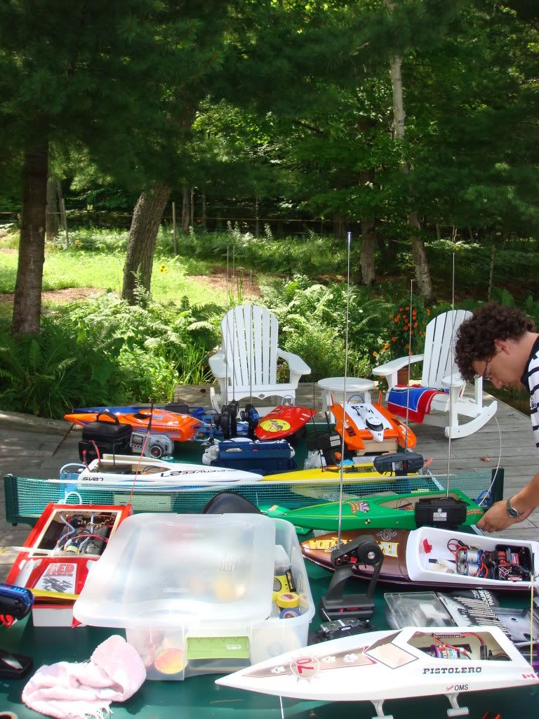

My whole reason for being into RC boats is a weekend of racing that my family does at our yearly family reunion at the cottage. It started with 3 boats including my old brushless mono, and has steadily increased to 10 boats in total. The rules are loose and the stakes are high... bragging rights and a small trophy. The field now consists of 4 SV-27's, a Fine brushless mono (very fast), a Fine brushless Cat, a Traxxas Villain, a couple other nice monos, and my UL-1.
