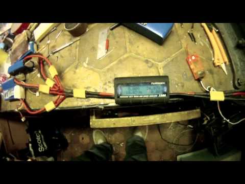

          Nice test on the EDF 1900kv 3659 motor from HK:
