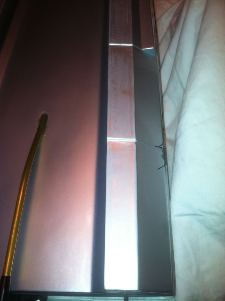

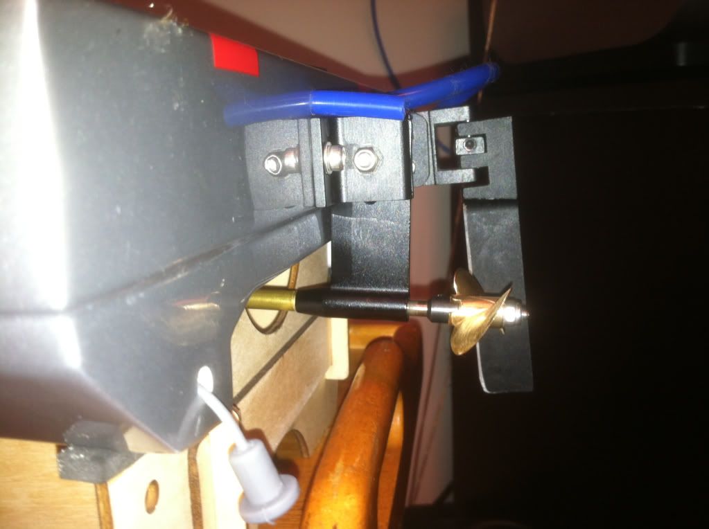

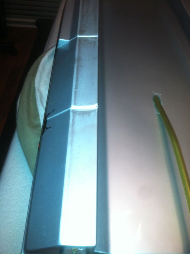

    Guess no one can help...that sux, but oh well went and did some changes and have made an improvement.
    I scuffed the bottom, lowered the strut a bit (although its angled bout like 1-2 degrees down, can't seem to level it suggestions??) and turned down the St rate.
    In this picture I think my rudder is Brant backwards a little
    Now its just taking along time coming out of the hole or dead stop to plane. I'm thinking it's an COG issue I got to work on.
    What are possible cause and solution. Thanks.

      It's hard to tell in the pictures, but it looks like you strut is really high. you might want lower it (deeper in the water). You should be able to flaten your strut angle too once it's deeper.

        The strut is level with the spontoons. Pic is tricky... When I try to level it out I have to pull out some of the brass tube in it....is that ok?

            Well i adjusted the batteries a tad bit, lowered the strut about 1/8" or so and scuffed some more the bottom and finished the scuff with 600 grit....here is a video of me running it. i think it helped alot. i like how she is handling. and i dont know if its because i adjusted the COG or lowered the strut a little but she launches alot better from a dead stop and corners pretttty good... take a look...

                i really appreciate that link, WOW it has some awesome tips. i think i am going to take a look at the bottom and make sure they are flat, otherwise i am going to do the same thing as you. also my rudder is not 90º its sticking away from the boat, so i am going to make it 90º.
