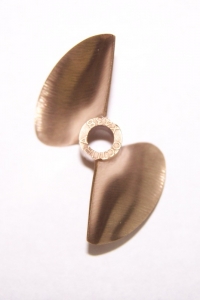

                Thanks Dasboata for the feedback. what is your opinion on the setup. Majority rules so I have two inputs, making yours the 3rd. Where would I get a x445 is that available on OSE?
                • tbonemcniel
                  • Sep 2020
                  • 296
                  This propeller is sharpened, balanced and thinned to increase performance over a raw or poorly prepared propeller.
                  That is already balanced and sharpened. They sell them cheaper raw if you have the capability to prep the prop yourself.

                    that's a fine place to start
