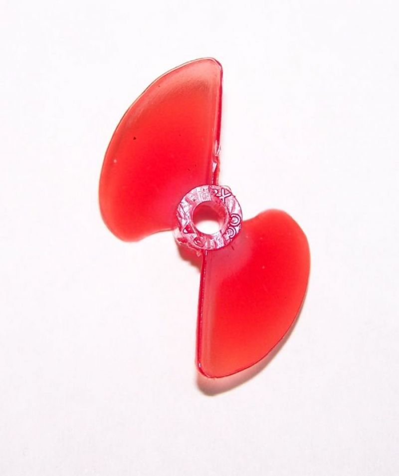

    the easiest thing to do would be to atapt an available prop to fit.
    Somthing like using nested brass sleeves over the prop shaft to fit the 1/8 normal shaft.
    https://www.amazon.com/PRECISION-MET...strial&sr=1-10
    a prop like this:
    you will need a drive dog, like this.

      Work with me here (simple mind). Is what your suggesting a brass sleeve to fit over my 3/32" threaded shaft? Is that sleeve threaded? Is the outside of the new brass sleeve measure 1/8" (size needed for the common size propeller)? Amazon seemed to want to take me to a kit with sleeves from 1/16" > 13/32" 12 pieces total. I am thinking I just need the 3/32 sleeve right?
      I am not familiar with the term drive dog. Is the drive dog the interface/tie between the brass sleeve and the new propeller?
